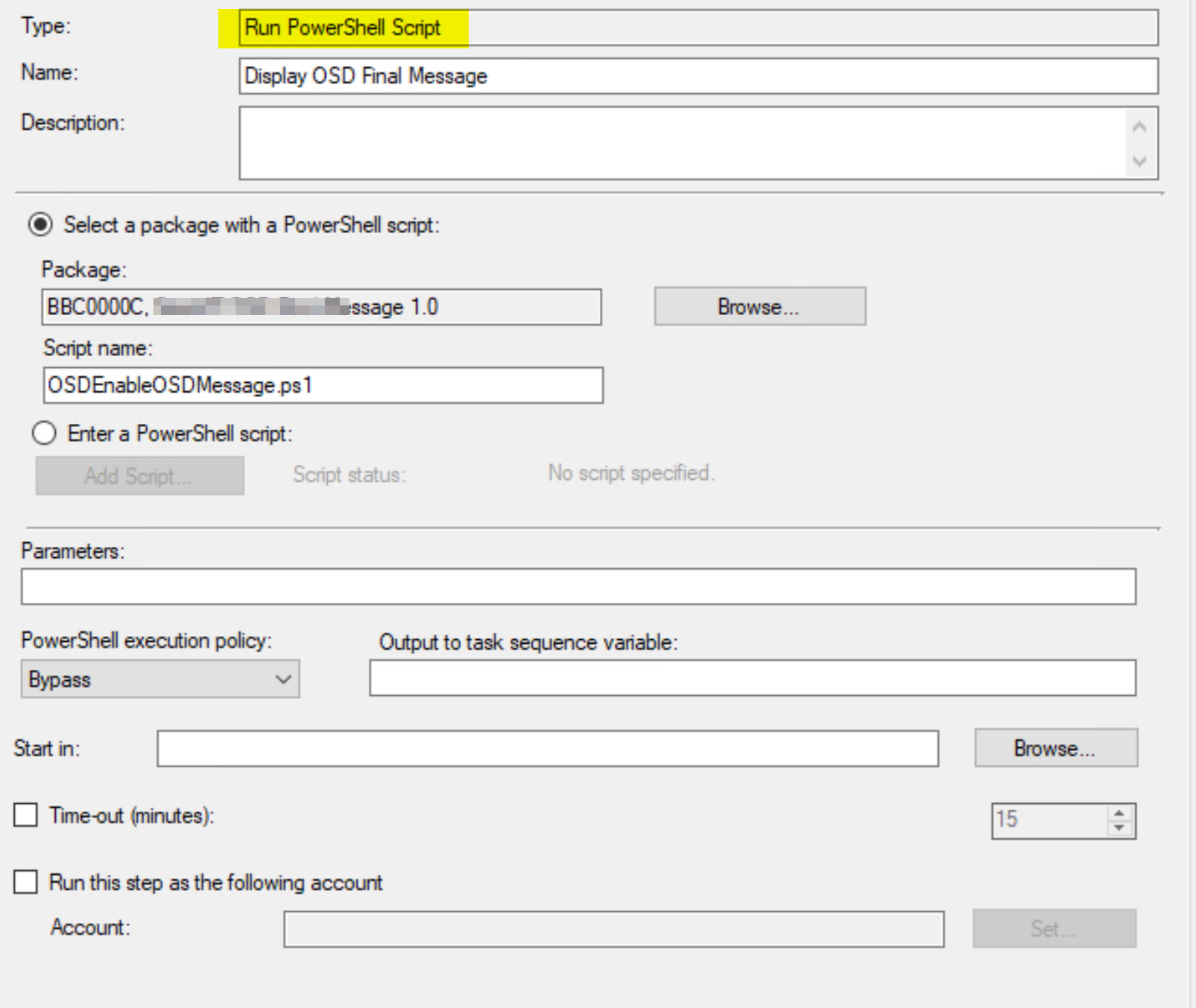

Try to run a Powershell Script from a TS that is deploying Windows 11. Using SCCM 2203 with HF Rollup.
TS Action "Run Powershell Script" with the option "Run the script from a package". Execution Policy "Bypass"
The TS Step fails with the following error:
PowerShell.exe does not exist at 'X:\windows\system32\windowspowershell\v1.0\powershell.exe'
Run PowerShell script failed to run, hr=0x80070490
Any advice? Thank you in advance.

    Are you sure the system is not in WinPE? Can you post the entire log?

    Did you confirm that PowerShell existing at that location?

    At what stage is the step running in the TS? What are you trying to run as part of the script?
