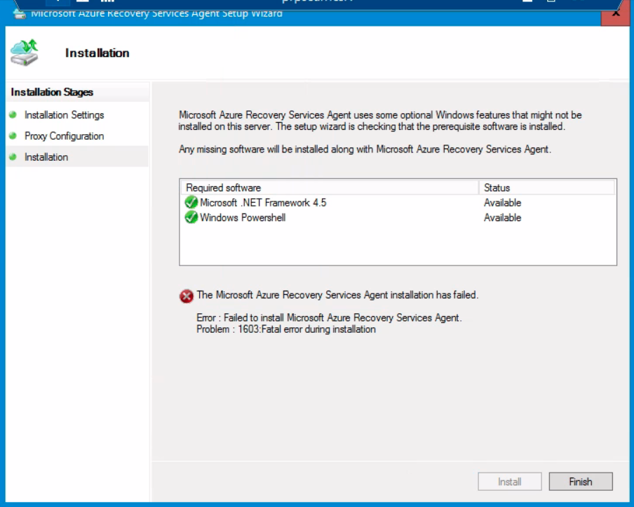

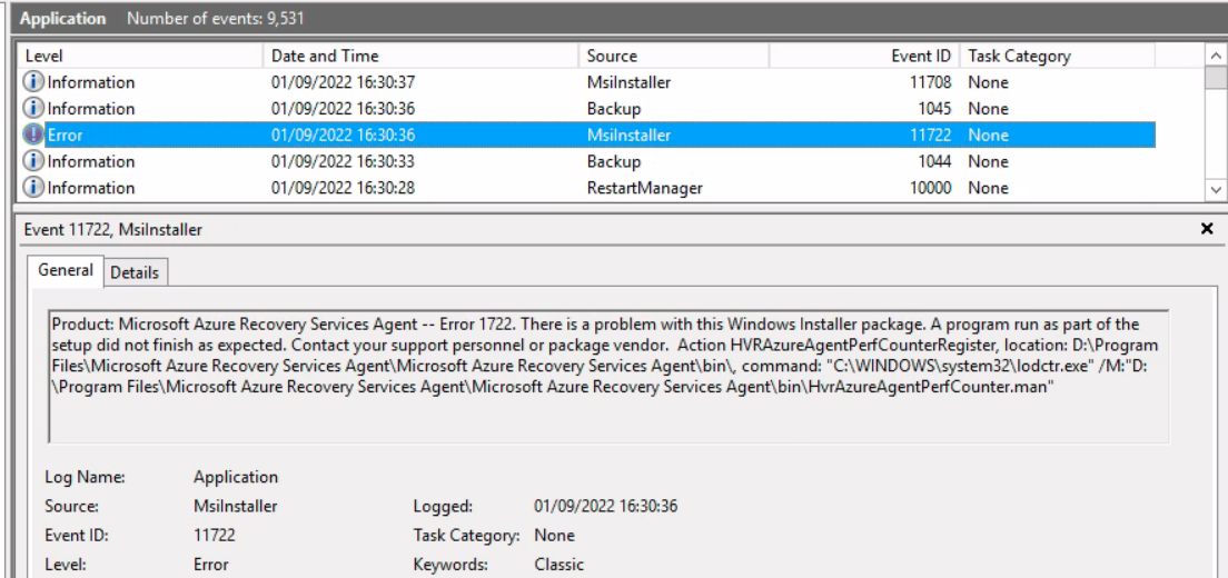

After upgrading a Domain Controller from Server 2012 to Server 2016 I am now unable to reinstall the Azure MARS agent for backup. I have tried a reboot of the server uninstalling and reinstalling the "Windows Server Backup" feature. Completely removing all refference to the MARS agent including folders and registry enteries. I have aslo tried the below commands to try and clean up the OS:
DISM.exe /Online /Cleanup-image /Restorehealth
sfc /scannow
I have also checked permissions of "SYSTEM" on the folders specified to install the agent too including trying different install locations.

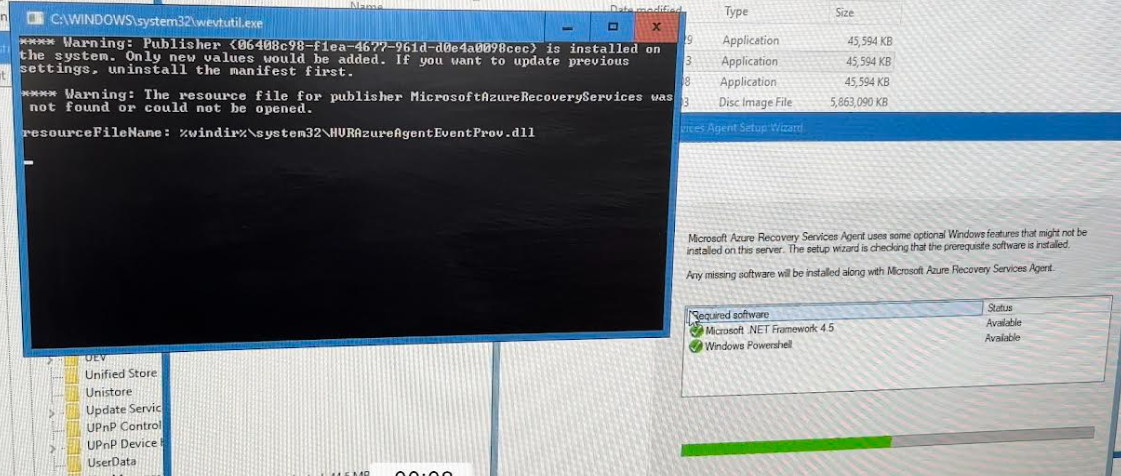

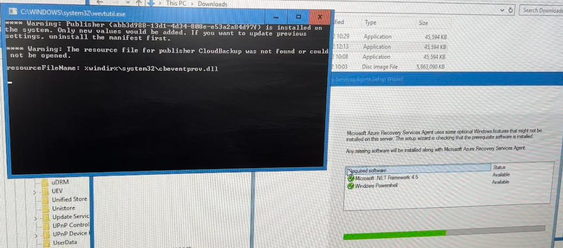

    Unfortunately, I have tried the above and this has not helped. Additionally, during the installation I see both of the below CMD boxes appear:

    Yes it seems the previous installation or configuration from the upgrade is causing conflicts, can you see if there are any references of the MARS agent on the server? I am afraid if everything fails you will have to raise a ticket with Microsoft to carry out detailed investigation on this.

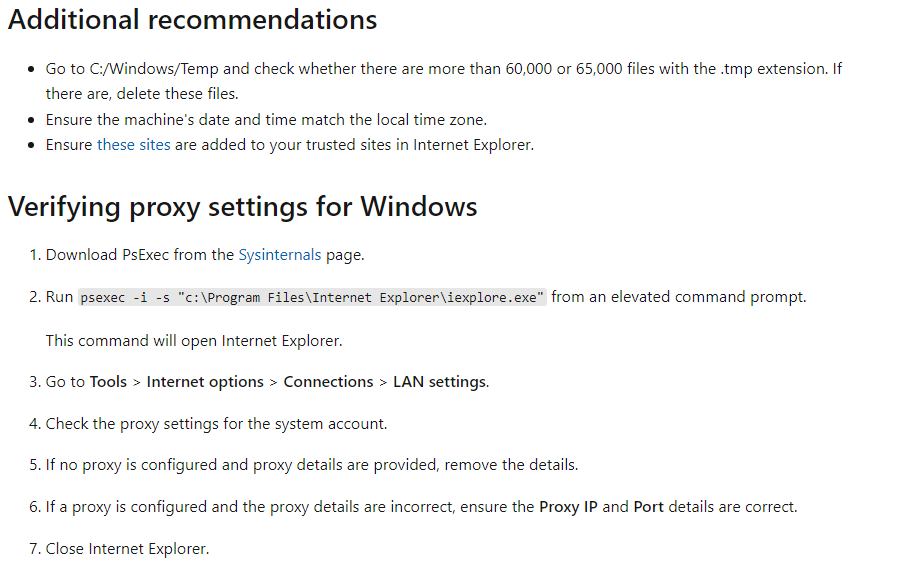

    Please see the following document for help with this:
    https://learn.microsoft.com/azure/backup/install-mars-agent
    You may also need to upgrade the agent now that you have upgraded the server:
    https://learn.microsoft.com/azure/backup/upgrade-mars-agent
