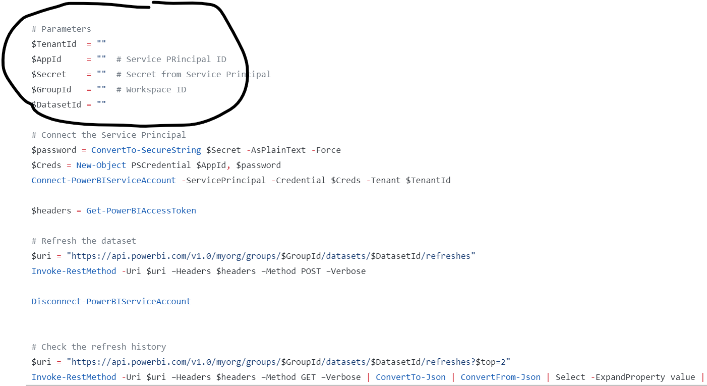

Hello All,
Good day!
The requirement is to execute the below powershell via SQL server job agent :
https://github.com/NickyvVr/PowerShell/blob/master/Power%20BI%20Dataset%20Refresh%20Service%20Principal.ps
How can we pass this highlighted credentials into the the SQL job without hardcoding it within the server?
Or Is there any way to link Azure key vault with the SQL server job.
Note: We cannot leverage AD Account to access as MFA is enabled on every account within the organization
