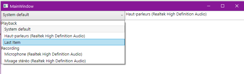

    </StackPanel>![237847-audiodevice-list.jpg][1]
I also give an example so, that it can be understand easily.
Just carefully see this image, this is my system scenario. I just take a screenshot of another paid application audio settings which I want to achieve in my WPF application also.
You clearly see the option Speakers (Conexant Smart Audio HD), in my my case this is my Laptop default audio speaker, until I insert any external audio speaker.
If I select this option "Speakers (Conexant Smart Audio HD)", the sound of this speakers are recorded in my paid application. And also there another option name "System default", if I select this "System default" option then still my Speakers (Conexant Smart Audio HD) sound will be recorded because it's my default audio device in this case.
This is the thing I want to achieve.
In this scenario, the Speakers (Conexant Smart Audio HD) disguise as "System default" option and appear in the top of the list, both selection give the same result.

  1. Castorix31 91,506 Reputation points
    2022-09-05T20:53:51.987+00:00
    Like in the other thread, add Id in the class :
    public class AudioDevice
        public string Name { get; set; }
        public string Direction { get; set; }
        public string Id { get; set; }
        public bool Default { get; set; }
    Then at beginning :
     devices.Add(new AudioDevice()  { Name = "System default", Direction = "Playback", Id = sIdDefaultRender, Default =  true });
     for (uint i = 0; i < nDevices; i++)
     // etc...
    In the loop :
     devices.Add(new AudioDevice()  { Name = sFriendlyName, Direction = sDirection, Id = sId, Default = (sId == sIdDefaultRender || (sId == sIdDefaultCapture)) });
