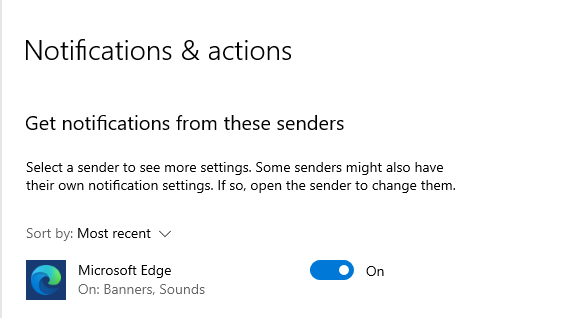

Notifications are enabled within the Windows 10 Settings:

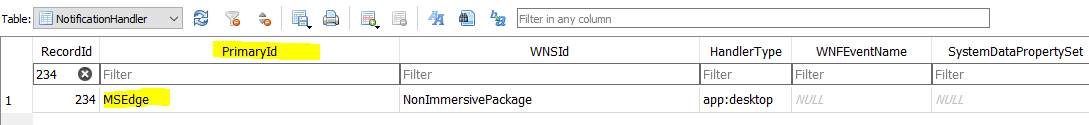

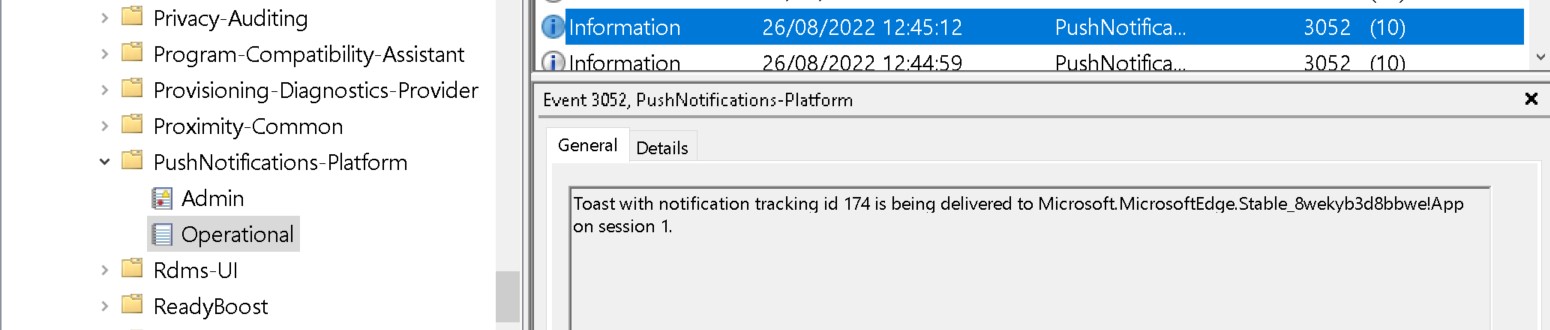

The Windows Event Log shows that the notification has been received by the Push Notification service:

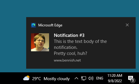

    I can see the Edge notifications in Action Center like below. I think the issue in your computer is related with Edge not showing in Get notifications from these senders. You need to turn on Edge option in it so that you can get notifications.
