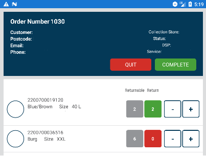

My view "OrderReturnView.xaml" looks like this;

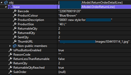

Upon clicking "+" the "obj" passed to the command is the specific line that had the "+" clicked;

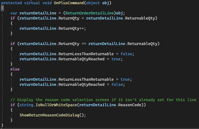

I added "ShowReturnReasonCodeDialog" to the plus command - this just sets the "IsVisible" bound bools to "true" to display the reason code selection popup. The user then selects a reason code from a drop down and clicks confirm.

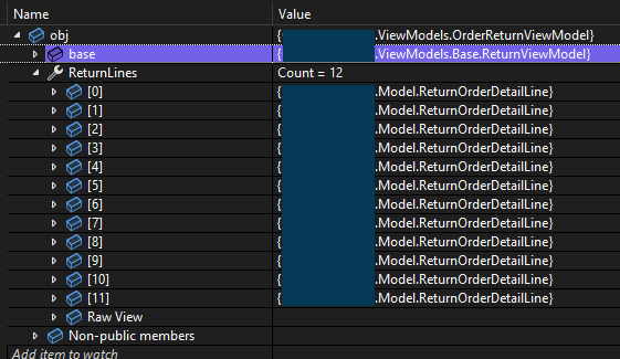

The issue here is that when "confirm" is clicked the data passed to "obj" is the entire collection of lines;
Whereas I just want the line that had the "+" clicked on it just before the popup was shown. I am guessing the problem here is something to do my Command/CommandParameter definitions for the confirm button however having had a read up on them I'm still unsure what I need to do - any ideas?

    Ok so you are using a list view but you aren't actually selecting the item in the list. In that case selection isn't going to work as you aren't using it. At this point I think you have a couple of options. Before calling ShowReturnReasonCodeDialog set the view model's SelectedLine property to the line item.
       if (String.IsNullOrWhiteSpace(returnDetailLine.ReasonCode))
          SelectedLine = returnDetailLine;
          ShowReturnReasonCodeDialog();
    The alternative would be to pass the returnDetailLine to ShowReturnReasonCodeDialog and have it do something similar.
