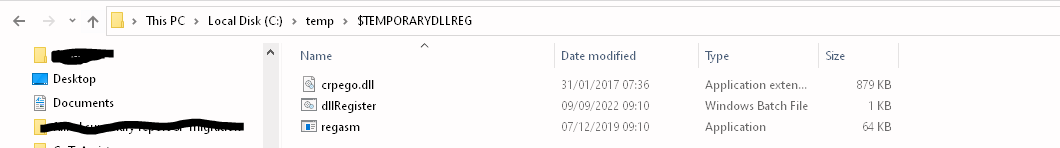

I am trying to run a log in script through group policy to install a dll file.
However, the script just tries to run the application file and states "can not find dll file"
Is there a way for the script to recognise the dll file in the folder?
My script is:
$folder = 'C:\temp\$TEMPORARYDLLREG\crpego.dll'
if (-not (Test-Path -Path $Folder)) {
start-process -FilePath "\\servername\Data\QuickCrpe\QuickCrpeReg.exe" -ArgumentList '/S'
else { }
result after running script

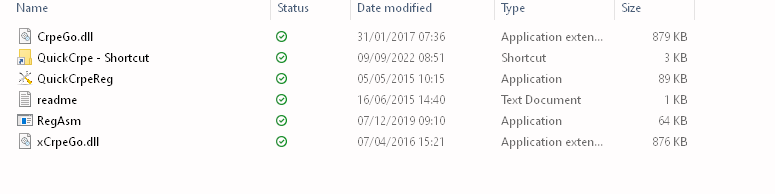

Result when running the application manually

    You didn't specify how you manually start the process (from cmd, explorer etc.) but this could be related to the working directory being different.
    You could try adding the -WorkingDirectory parameter to the Start-Process line:
    start-process -FilePath "\\servername\Data\QuickCrpe\QuickCrpeReg.exe" -WorkingDirectory "\\servername\Data\QuickCrpe" -ArgumentList '/S'

    I see that you experience some problems with the script it self. I would try to keep dll and exe file inside source folder, together with ps1 and see if it will launch it then as it should. Or if you really want to run it from C:\temp, do file copying first.
