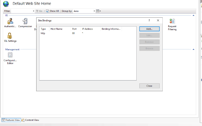

    Hi Muthu Mahadevan,
    Thanks for your reply. According to the screenshot you provided, is the host name of the http binding originally empty? If so, it means that there is no HTTP binding. Please create a new binding without a host name and with an IP address of "All Unassigned". In addition, if you add the server to the exception list to allow traffic (when the proxy is configured, it routes requests through the proxy server. If the incoming request is blocked on the proxy server, it may cause this problem.), you can use the following CMD command to check.
    netsh winhttp show proxy
    If there is a proxy, you can use the following CMD command to remove it.
    netsh winhttp reset proxy
    If the above methods still cannot solve the problem, it is recommended that you use a packet capture tool such as wireshark to find out the specific cause.

    Hello Zunhui,
    Thank you for your response. In the Forwarder (Windows Server 2019), Since we did not have IIS Manager, We installed it. When clicked on "Default Site" and selected "Edit Bindings", HTTP binding existed. Please check the below image for reference.
    Ran gpupdate /force in the forwarder, but still getting EVENT ID 105 - The WinRM client sent a request to an HTTP server and got a response saying the requested HTTP URL was not available. This is usually returned by a HTTP server that does not support the WS-Management protocolKindly let me know what settings to change. It will be of great help to us.
