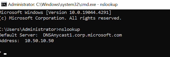

    7. Test with nslookup:
    On the client machine, try using nslookup to resolve the domain name and see if it correctly resolves to the AD DC’s IP address. This can help confirm if DNS settings are correct.

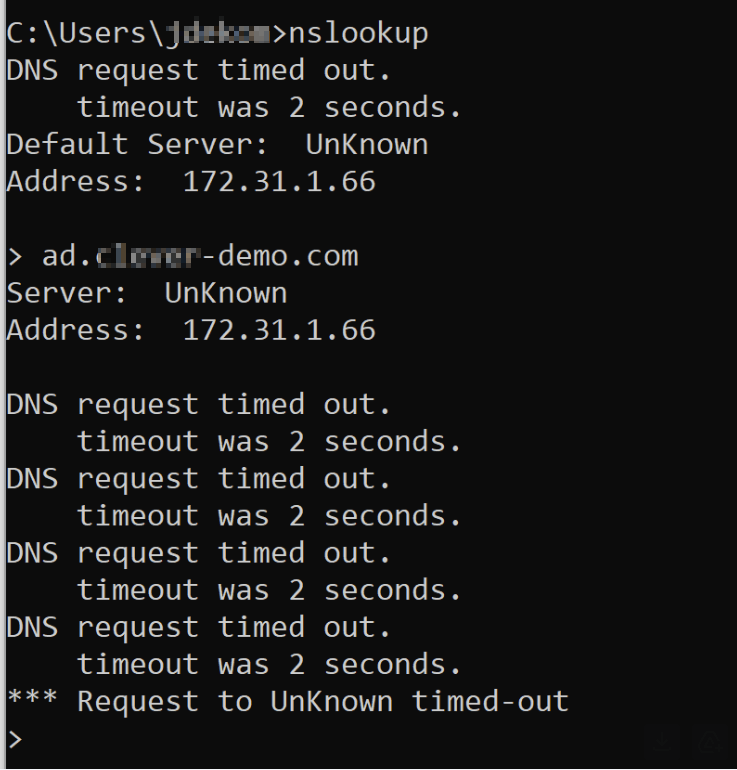

    ISSUE - Test with nslookup - doing an nslookup does not resolve which I know is a probelm but not sure how to fix it:

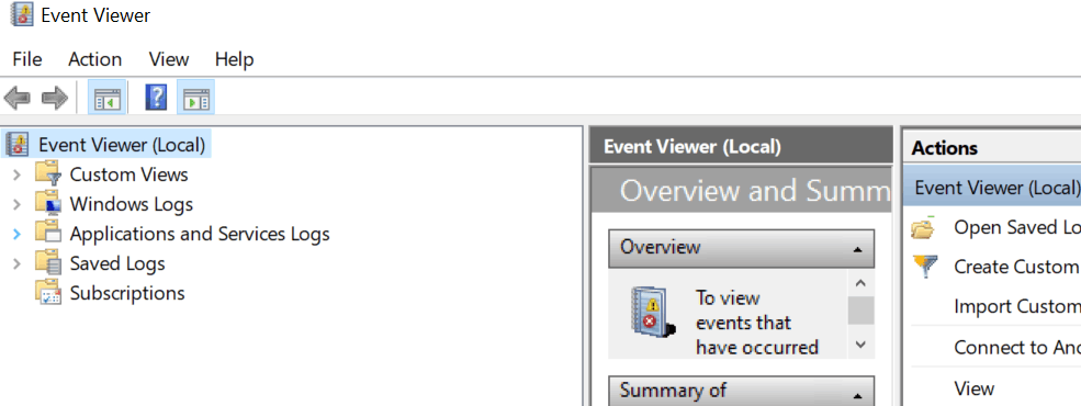

    Check Event Viewer - I am not seeing anything in Event Logs that is revealing
