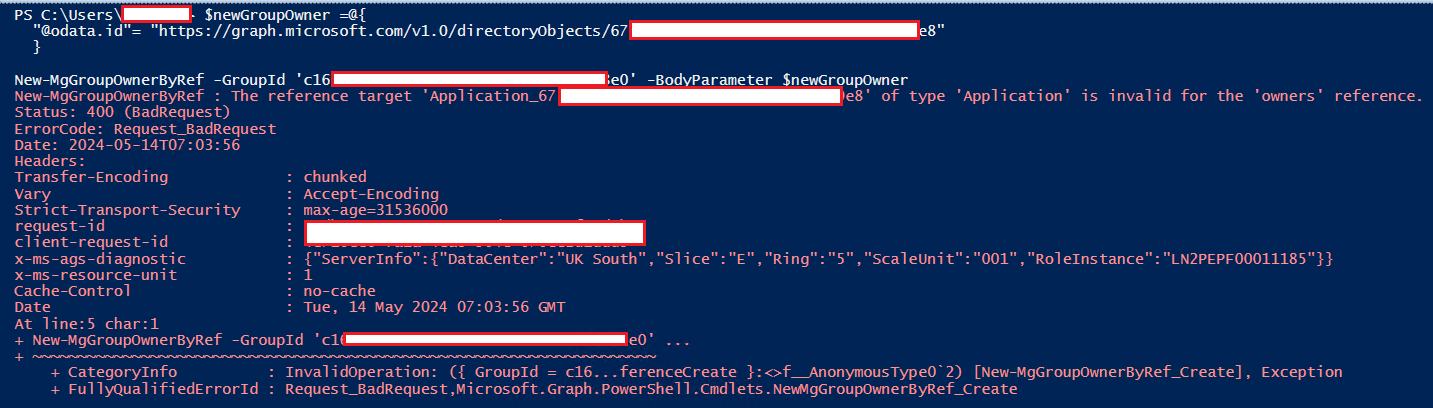

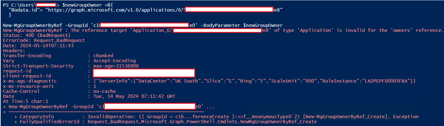

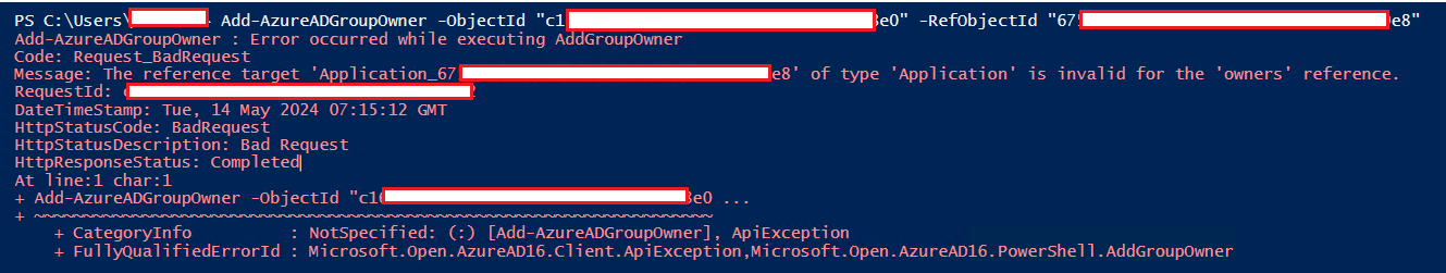

I am trying to add an application as an owner to a few Azure AD group but encountering below error message:
"The reference target 'Application_xxxx-xxxx-xxxx' of type 'Application' is invalid for the 'owners' reference."
I tried with AzureAD PS module (Add-AzureADGroupOwner) as well as MS Graph (New-MgGroupOwnerByRef), but nothing works and throws the same error.

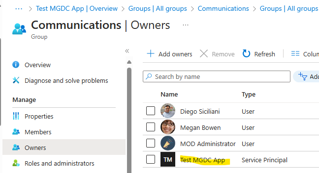

When I try to add the same app as owner manually through GUI (on Azure AD portal) that works fine.

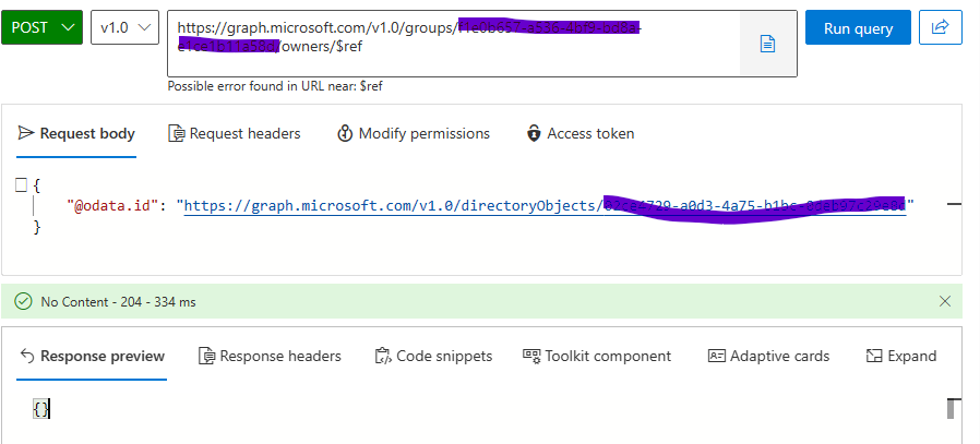

    Azure AD does not support adding applications as owners to groups directly. Instead, you should add the service principal of the application as the owner. The service principal represents the application in the directory and has a different object ID from the application object ID in app registrations.
    Here’s what you can try:
    Obtain the Object ID of the service principal associated with your application. You can find this in the Enterprise Applications section of the Azure portal.
    Use the Object ID of the service principal to add it as an owner to the Azure AD group.
    For example, using Microsoft Graph API, your request would look something like this:
    POST https://graph.microsoft.com/v1.0/groups/{GroupObjectID}/owners/$ref
    Content-type: application/json { "@odata.id": "https://graph.microsoft.com/v1.0/directoryObjects/{ObjectIdOfServicePrincipal}" }
    Make sure to replace {GroupObjectID} with the actual object ID of the group and {ObjectIdOfServicePrincipal} with the object ID of the service principal.
    You can use the above graph api call in Invoke-RestMethod powershell command or in Graph Explorer.
    For your reference, https://learn.microsoft.com/en-us/graph/api/group-post-owners?view=graph-rest-1.0&tabs=http, https://stackoverflow.com/questions/70167600/microsoft-graph-addowner-api-does-not-let-me-add-an-application-as-group-owner
    I tried in my environment using Graph Explorer.
