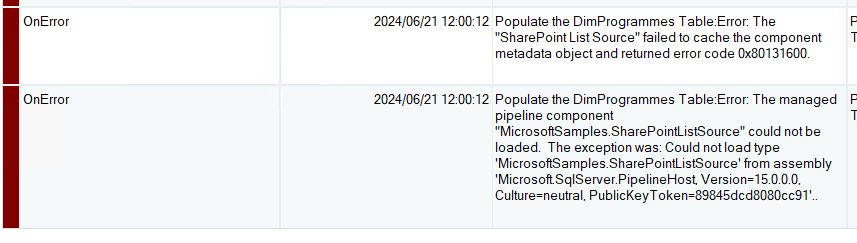

  3. I then deploy my Project packages to the same server that Visual studio is running on,In MSSMS Under Integrated Services Catalog\SSISDB.When i try validating/Executing one package,that is when the error below appears.
       could not load type 'Microsoftsamples.sharepointlistsource' from assembly microsoft.sqlserver.pipelinehost,version 15.0.0.culture=neutral,publicKeyToken=8985dcd8080cc91.
