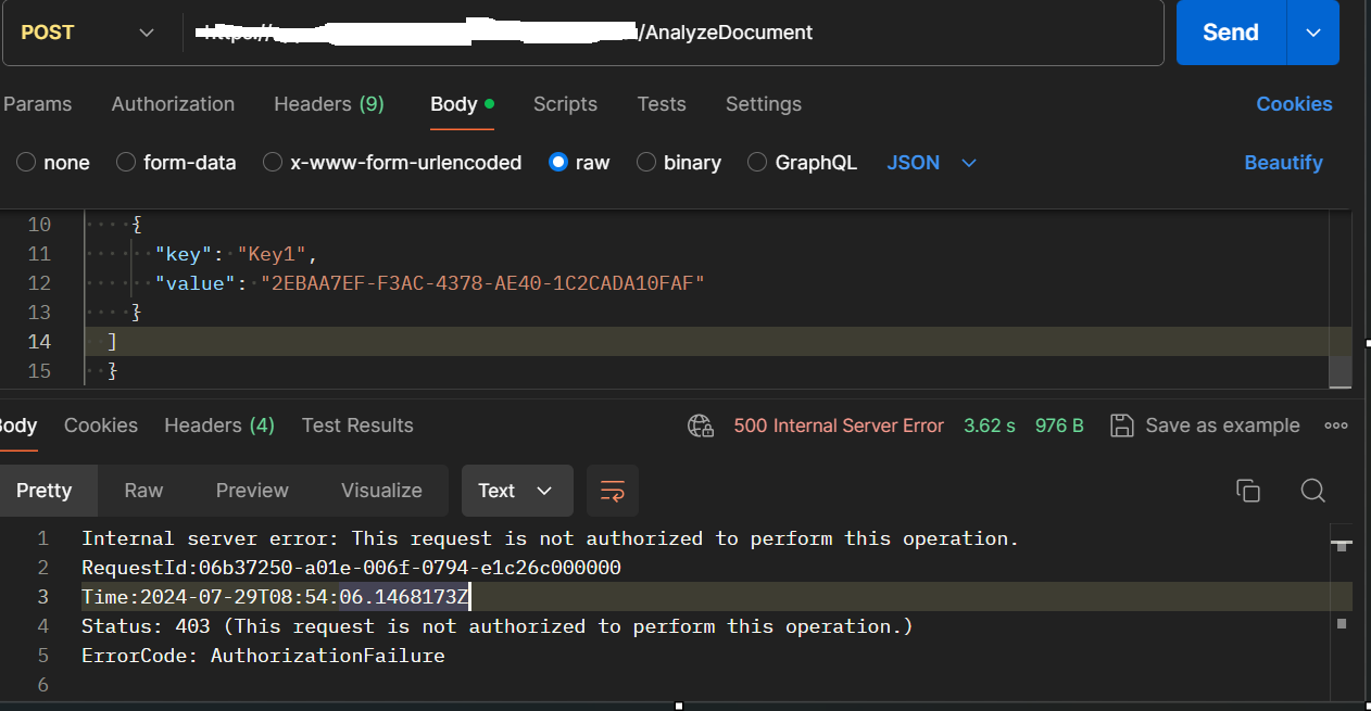

I understand that when you try to upload data to blob through app service Post API you are receiving the 403 error with the message “This request is not authorized to perform this operation” and the error code AuthorizationFailure typically indicates that the request lacks the necessary permissions to access the resource or the access restrictions on the blob storage are preventing the APIs from accessing the storage.
