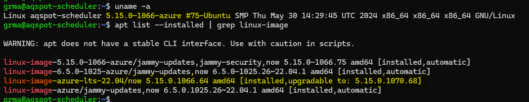

We need to ensure that both our Scheduler and Execute nodes are fully patched and up to date, including kernel packages and others that require a reboot after installation.
We are running the Microsoft HPC Ubuntu 22.04 image, and I know it is possible to update packages on every node startup using a YAML Cloud-Init script, but I suspect the need to reboot the nodes after a kernel update might cause this not to work with CycleCloud?
So, is there a way to do this with CycleCloud and Cloud-Init, or is it best just to take a copy of the Microsoft HPC Ubuntu 22.04 VM image and then customise it and apply any updates every month?

    Following up on this since speaking with one of the DEVs of the HPC images - they say to use their MS Supplied images as they are updated reasonably regularly and that they explicitly disable the Kernel updates as updating would break the other HPC software in the images:
    Thanks for raising this issue. Generally, OS kernel updates break compatibility of HPC components, e.g., Lustre. In our HPC images, the kernel is excluded from updates for this reason. Ubuntu 22.04: https://github.com/Azure/azhpc-images/blob/0b14bf6158ee5aaecf73f1e78ed9f0988bb722ed/ubuntu/ubuntu-22.x/ubuntu-22.04-hpc/install_prerequisites.sh#L5 AlmaLinux 8.7: https://github.com/Azure/azhpc-images/blob/master/alma/common/install_utils.sh#L66 We implement this way since lots of kernel dependencies are installed which are highly coupled to a specific kernel. Thus kernel updates are not encouraged in our HPC images. Our HPC image releasing cadence is quarterly. In the meantime, if we get flagged for security issues, we quickly apply the patch and release a hotfix in an adhoc fashion which can be done within a week or two. What you need to do is just to use our latest HPC images. Or you may report security bugs (and patches, if any) to us. We will apply the fix and release the patched images.
