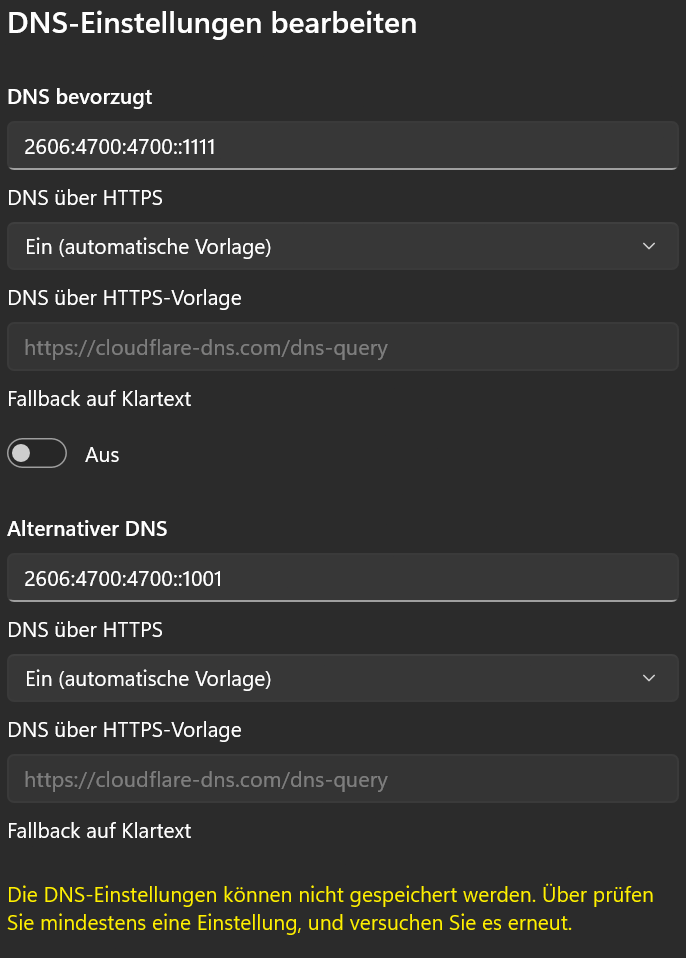

I want to set up DNS over HTTPS (DoH) for IPv6. The provider in this case is Cloudflare. However, I get the following error message when I try to save the settings:
I have double-checked all entries, everything should be correct. I have also checked the steps with the help of these instructions ( https://www.elevenforum.com/t/enable-dns-over-https-doh-in-windows-11.280/ ) to see if an error has crept in. Did I make a mistake in the configuration?
DoH works fine over IPv4 only IPv6 just doesn't.

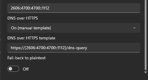

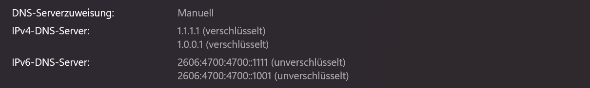

2025-01-26T21:41:42+00:00
Hi @Kxixca,

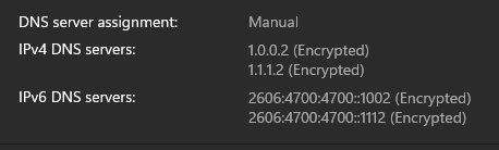

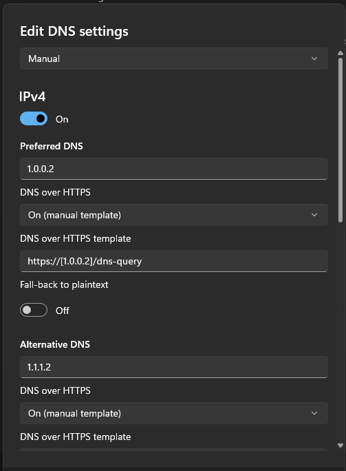

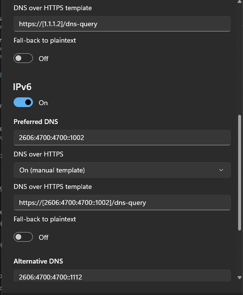

I think I have solved the problem. Please set Cloudflare DNS IPv4 and IPv6 address correctly using square brackets in the https:// URL because they are all numbers.
I have performed no further setting anywhere else.
Note: I am using the addresses of Cloudflare for Families, Set up 1.1.1.1 on Windows · Cloudflare 1.1.1.1 docs
And I have got this in the end:

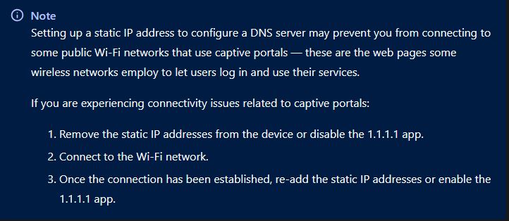

However, please bear in mind this remark from that page I have mentioned from Cloudflare:

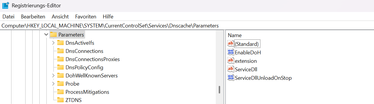

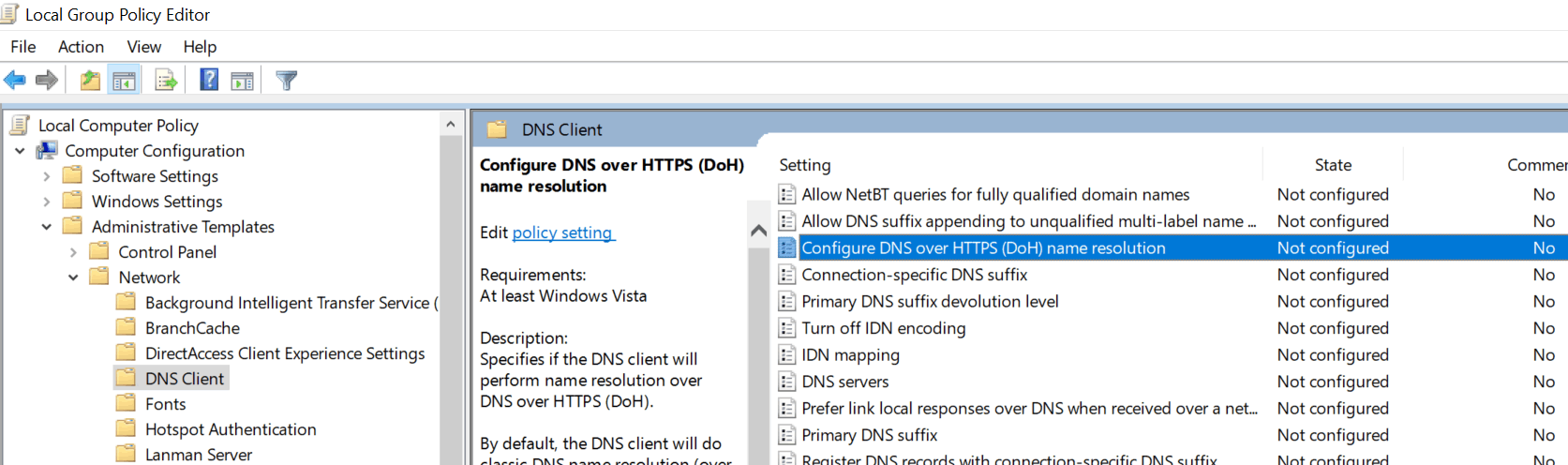

    2024-12-25T16:00:18+00:00

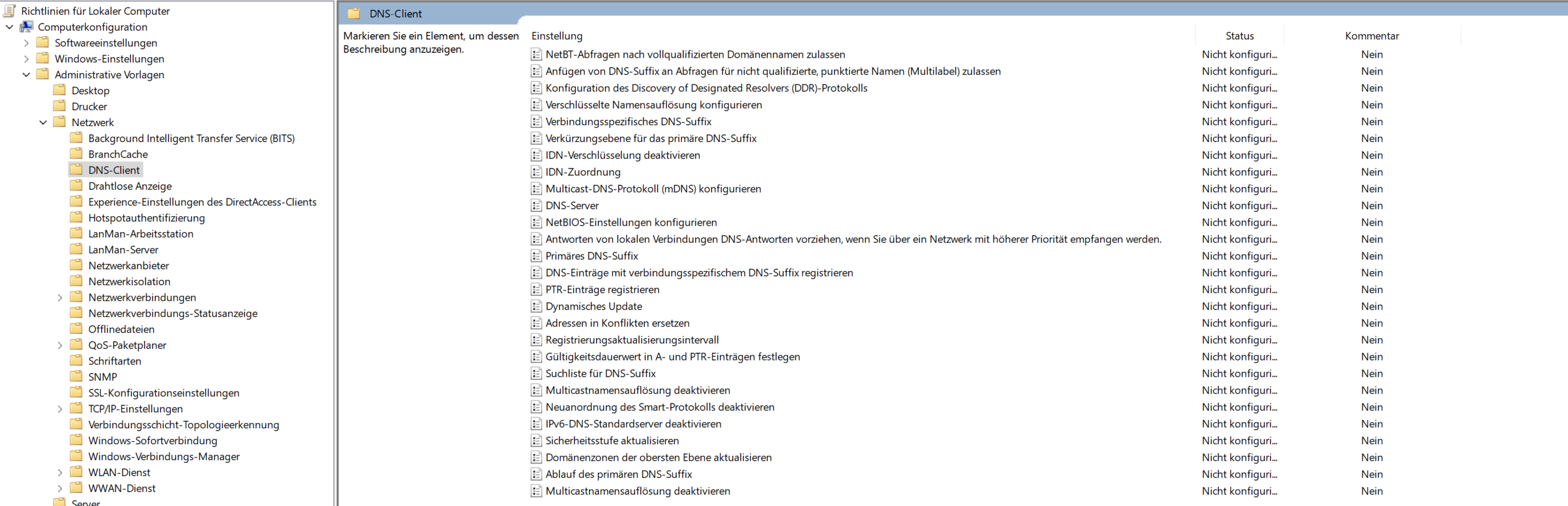

    I added the key value to the registry and restarted the computer. However, the "Configure DNS over HTTPS (DoH) name resolution" option is still not present:
    Maybe the option does not show up in Windows 11, but it does in Windows 10, or is there no difference at all?

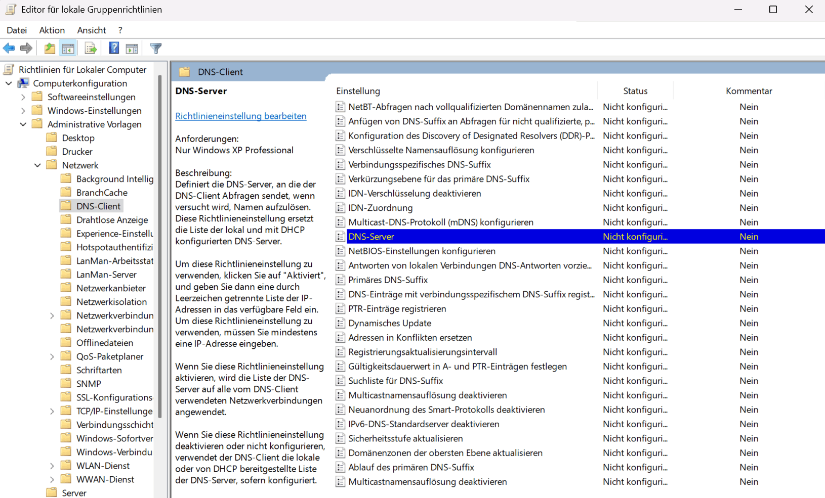

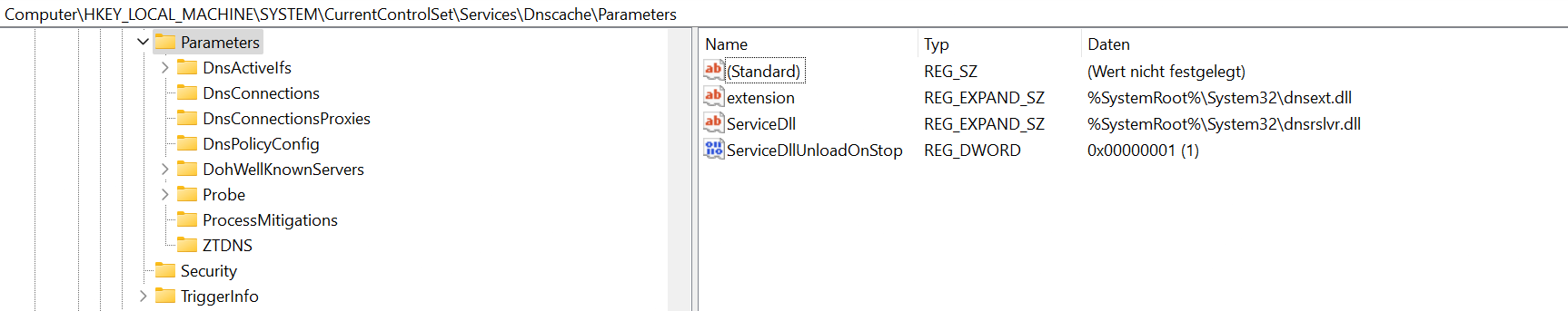

    2024-12-24T14:16:37+00:00
    The default group policy has this configuration as shown in the figure below. You can try to add this key value in the registry and restart the computer to see if this problem can be solved:

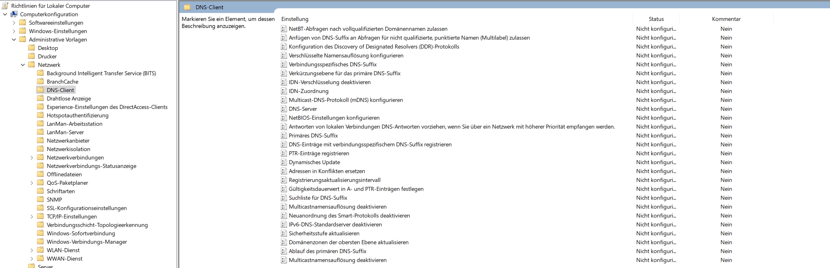

    2024-12-22T21:13:32+00:00
    Hello,
    Sorry for the late reply. I looked at the two methods you mentioned. However, I could not find the options mentioned in the methods either in the Group Editor or in the registry?
    Can the Configure DNS over HTTPS (DoH) option be added manually in method 1 or is it not possible?
    In method 2, does the DWORD key need to be created in the Parameters folder?
    2024-12-17T08:38:20+00:00
    Hello,
    Even if DoH is enabled, DNS settings that are not configured correctly will result in "Not Encrypted" being displayed. You can confirm that the configuration is correct in the following ways.
    Method 1: Group Policy Settings
    Press Win + R, enter gpedit.msc to open the Local Group Policy Editor.
    Navigate to: Computer Configuration > Administrative Templates > Network > DNS Client Double-click Configure DNS over HTTPS (DoH), select "Enabled", and enter your DoH server URL.
