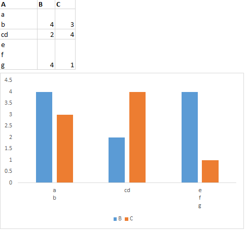

    To wrap in Excel charts, there are two possible methods
    1. Method 1 - Wrap your text by forcing next line by pressing ALT+ENTER. Below b is forced down by ALT+ENTER. Same for e f and g. d is not forced down by ALT+ENTER.
    Now, in the chart they are wrapped.

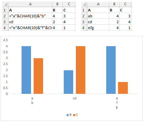

    1. Method 2 - You will have to use formula = "First Line"&CHAR(10)&"Second Line"&CHAR(10)&"Third Line" and so on
    See below example -
    1. ab has been entered as ="a"&CHAR(10)&"b"
    2. cd has been entered as cd itself i.e. without CHAR(10)
    3. efg has been entered as ="e"&CHAR(10)&"f"&CHAR(10)&"g"
    Now, in chart ab and efg are wrapped whereas cd is not wrapped.

    Hi Vijay, many thanks for your quick response. In the data sheet, both methods worked. However, in the chart, it shows the first word, followed by "..."  For example, I had ="Customer"&CHAR(10)&"Service" and it shows on two lines in the datasheet.  However, in the chart it shows Customer...  I feel we are on the right track, and half way there. I would appreciate some advice as to how I now get it to wrap in the labels.  Very many thanks again.
    2014-06-29T07:13:03+00:00
    What a star you are! I simply enlarged the chart and it all fell into place! Thanks so much to you, Vijay.  Best wishes.
