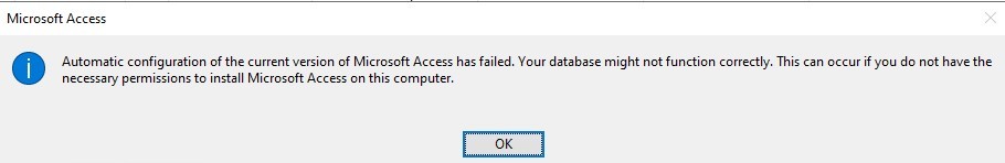

Back to main point now, all the Office applications that are installed in the suite open without issue (as 32-bit), but whenever I open MS Access, I run into the error where it states as follows in the pictures below.
"Automatic configuration of the current version of Microsoft Access has failed. Your database might not function correctly. This can occur if you do not have the necessary permissions to install Microsoft Access on this computer."

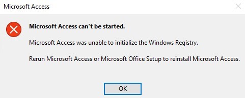

If I then press OK, I run into this next error window.
"Microsoft Access can't be started. Microsoft Access was unable to initialize the Windows Registry. Rerun Microsoft Access or Microsoft Office Setup to reinstall Microsoft Access."
