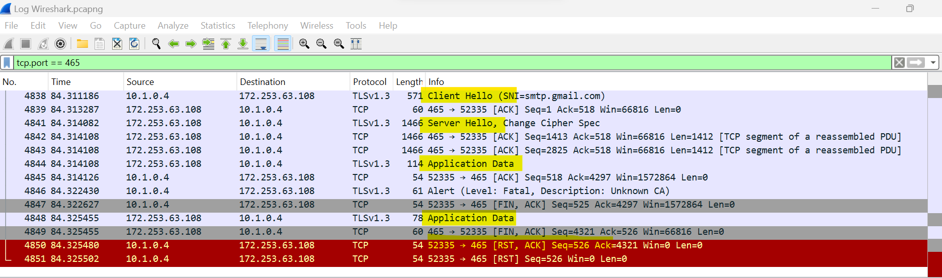

I am currently trying to send an email using Aveva Edge 2023 software on port 465 through the smtp.gmail.com server but it cannot send.
I am using the trial version for 1 month and I understand that for these versions the email output through port 25 is blocked.
I would like to know if there is a block by Azure for my test of sending mail through port 465.
I am attaching the logs with the wireshark software to see if it is of any help.

    I checked the logs and can see that port 456 is open. The TLS handshake is happening just fine, and I can also see some encrypted Application data being transferred. But then there is a TCP reset at the end (I believe sent by the application). It looks like an application issue.
    I would request you to check the application for any issues and further troubleshooting.
