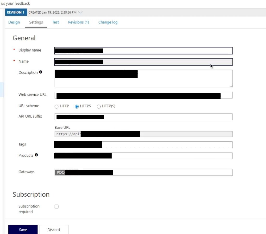

I configured a self-hosted gateway and deployed it on a Docker machine. I've already configured the API to use the self-hosted gateway, uploaded the certificate, and so on, but I have two specific questions. The application consuming the endpoint is still using the base URL from the API's custom domain. The other question is that when I switch it to use the self-hosted gateway, the base URL doesn't change; it remains the one from the Azure API's custom domain. Does anyone have any idea what I might be missing to get it working correctly?

  1. Asigna tu API al gateway autoalojado
    Por defecto, las APIs solo están asociadas con la pasarela gestionada basada en la nube.
    • En el portal de Azure, ve a tu instancia APIM > APIs > selecciona la pestaña de Configuración > API ____ .
    • Desplázate hacia abajo hasta Gateways (o asociaciones de Gateway) y asegúrate de que tu gateway autoalojado esté comprobado.
    • Nota: Solo las APIs asignadas explícitamente a una puerta de enlace aparecerán (y podrán ser llamadas) a través de esa pasarela.
