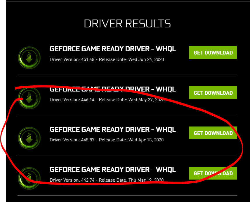

    Visit the Nvidia site > select Manual Driver Search and use one of the older drivers located below the current release. See attachment.
