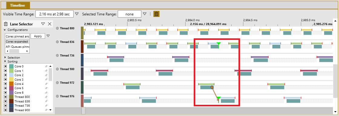

    Figure 1. A zoomed-in view of PIX thread timelines that shows thread 836 floating between cores
    Screenshot of a zoomed-in view of PIX thread timelines that shows thread 836 floating between cores
  4. Consider thread 836 in figure 1. Notice that it's running on both the green core (core 1) and the light-blue core (core 2). Move your mouse over any of the upper event lines to highlight the section, and it displays a pop-up window that tells you which core it represents.

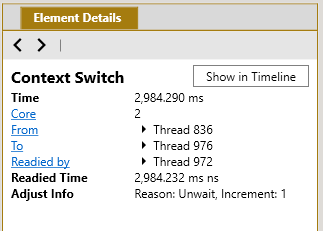

  5. Notice that thread 836 is floating between cores 1 and 2—upon which threads 972 and 976 are already executing (see figure 2). Look at the selected context switch with the arrow. Notice that thread 976 was readied by thread 972 at the end of its task. However, thread 976 has its affinity set to run only on core 2. Therefore, it had to be switched in 58 μs later from 836 (which was occupying core 2 at the time). While this is a trivial example, it demonstrates how floating threads can affect the performance of other threads.
    Figure 2. The element details for the context switch that was selected in figure 1
    Screenshot of the element details for the context switch that was selected in figure 1

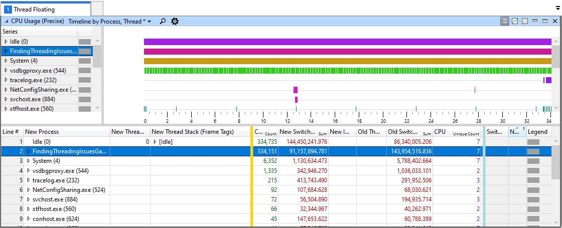

    Figure 3. Default view of the ThreadFloating WPA profile
    Screenshot that shows the default view of the ThreadFloating WPA profile

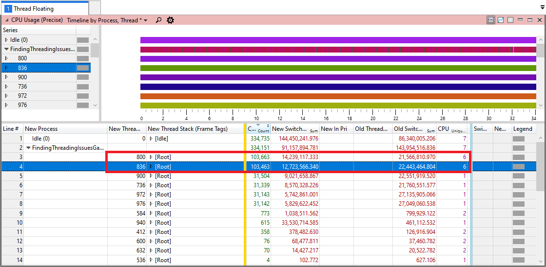

  3. With this WPA profile, the CPU column has been set to show the Unique Count for each line (see figure 4). This shows you the number of unique CPU values that ETL events reported for that process and thread. Any value above one means that the thread floated between CPU cores at least once during the visible time frame.
    Figure 4. Focusing on unique CPU values for threads, threads 800 and 836 are running on six different cores
    Screenshot that shows threads 800 and 836 running on six different cores

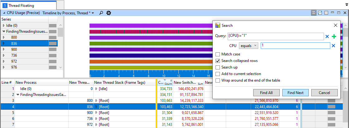

  4. Find threads floating onto a critical core. To do so, right-click the CPU column, and then select Find In Column.... This searches for all threads that are floating to that particular core.
    Figure 5. Using the Search feature to locate all threads that were running on core 1 during the capture
    Screenshot showing how to use the Search feature to locate all threads that were running on core 1 during the capture
