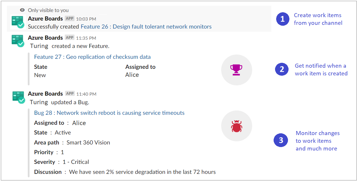

The Azure Boards app for Slack allows users to set up and manage subscriptions in their Slack channel. They can manage subscriptions for create, update, and other work item events. Users can also get notifications for these events in their Slack channel. Conversations in the Slack channel can be used to create work items. Previews for work item URLs help users to start discussions around work.
Pic: Notification

  • Create work items from your Slack channel
  • Monitor work item activity in your Slack channel

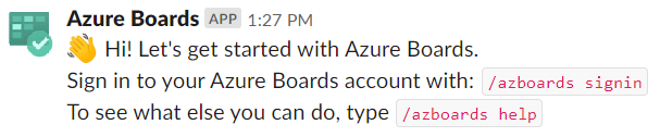

  2. Once added, you'll see a welcome message from the app as shown in the following image.
    Pic: Welcome message
  3. Use the /azboards Slack handle to interact with the app. A list of commands is provided later in this article, Command reference.

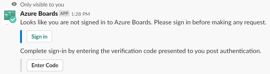

  1. Once the app has been installed in your Slack workspace, connect and authenticate yourself to Azure Boards.
    screenshot of sign-in

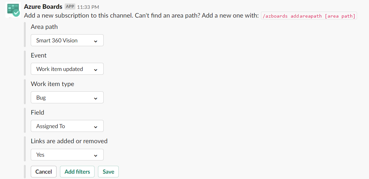

You can create subscriptions to monitor work items at any time using the /azboards subscriptions command. You have an option of setting up subscriptions just after linking a project.
  1. Select area path you want, the event that you're interested in, and use the associated filters to customize your Slack channel. To easily set up subscriptions, your recently accessed area paths are shown in the area path dropdown.
    Set up subscriptions.
    In case your team's area path doesn't appear in the Area path dropdown menu, follow the instructions mentioned in the next section, Add area paths. Area paths added using the /azboards addAreapath command and area paths for which subscriptions are created in the Slack channel always appear in the Area path dropdown along with recently accessed area paths.

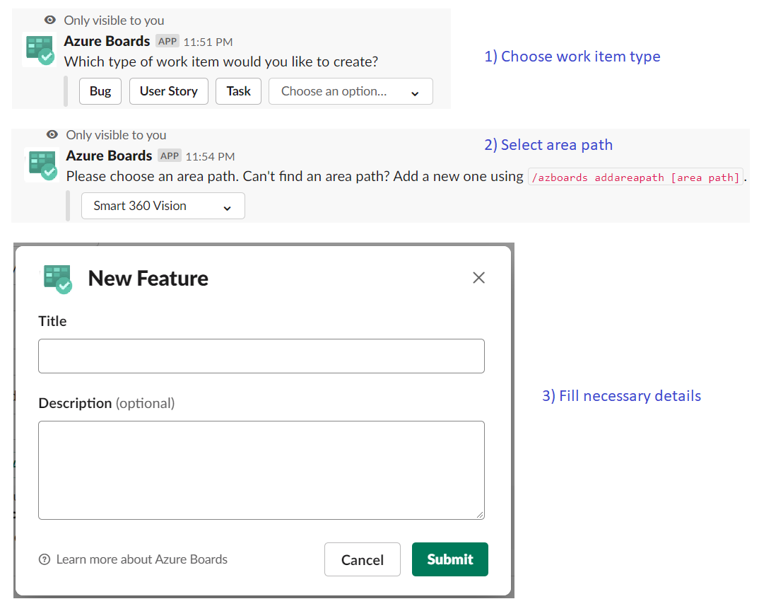

Create a work item with a command
  1. With the Azure Boards app, you can create work items from your channel. The app supports custom work items as well.
  • To create a work item, use /azboards create.
    Create work item using command
  1. You can create work items directly from a command by passing work item type and title as parameters. Work items get created only if they don't have any fields to be mandatorily filled.
     /azboards create [work item type] [work item title]
    For example:
     /azboards create 'user story' Push cloud monitoring alerts to mobile devices

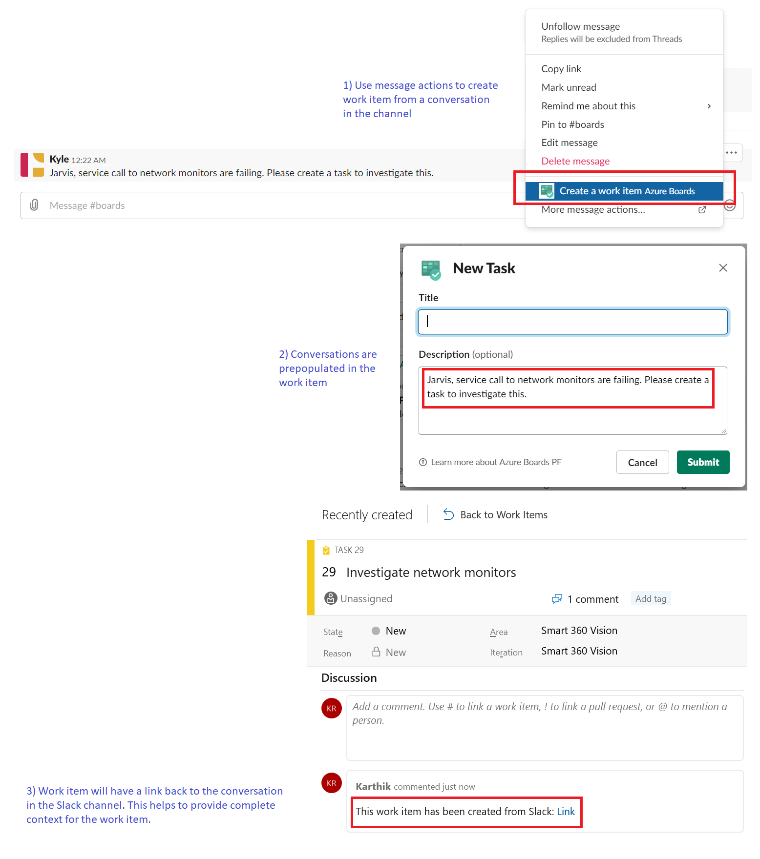

Create a work item from message actions
Often, discussions in a channel call for creation of work items. You can use message actions to create a work item. The selected message is prefilled in the description section of the work item. A link back to the conversation in the channel is stored in the Discussion section of the newly created work item, giving users access to the discussion that led to the creation of the work item.
  • To create work items using message actions
    Create work item using message action

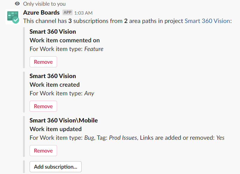

Manage Azure Boards subscriptions
  1. To view, add and remove subscriptions for a channel, use the /azboards subscriptions command:
    This command lists all the current subscriptions for the channel and allows you to add new subscriptions and remove existing ones. As part of adding subscriptions, you can also customize what you get notified on by using various filters.
[!NOTE]Team administrators aren't able to remove or modify subscriptions created by Project administrators.
Pic: View subscriptions

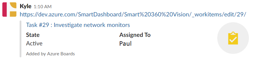

Previews of work item URLs
To support collaboration around work items discussed within a channel, a preview of work items referenced in the channel is displayed. When a user pastes the work item URL, a preview is shown similar to the following image. This preview helps to keep work-item-related conversations relevant and correct.
Pic: URL unfurling
For this feature to work, users have to be signed-in. Once they're signed in, this feature works for all channels in a workspace.

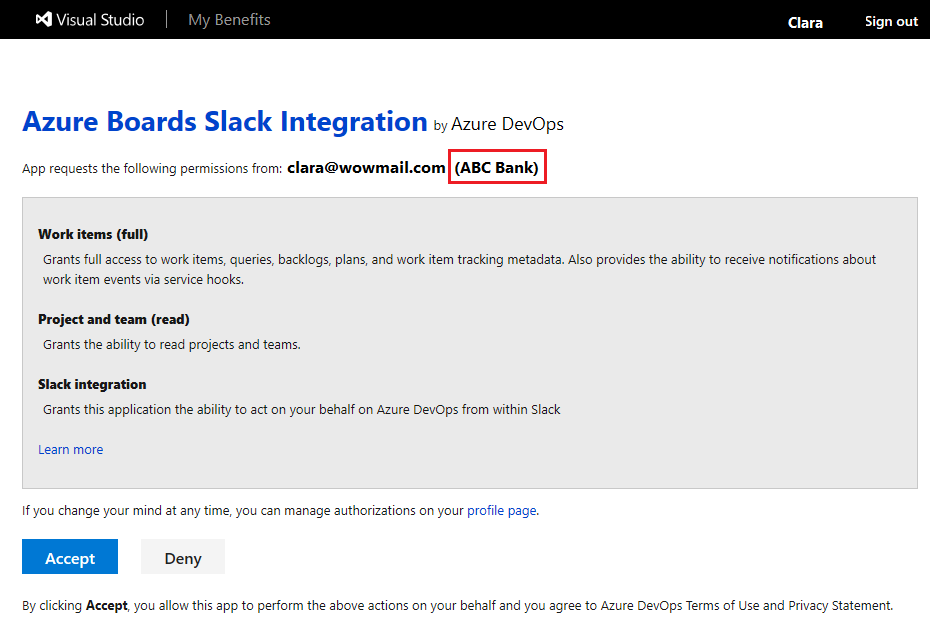

Select the Sign in button and you'll be redirected to a consent page like the one in the following example. Ensure that the directory shown beside the email is same as what was chosen in the previous step. Accept and complete the sign-in process.
Consent to the requested app permissions
