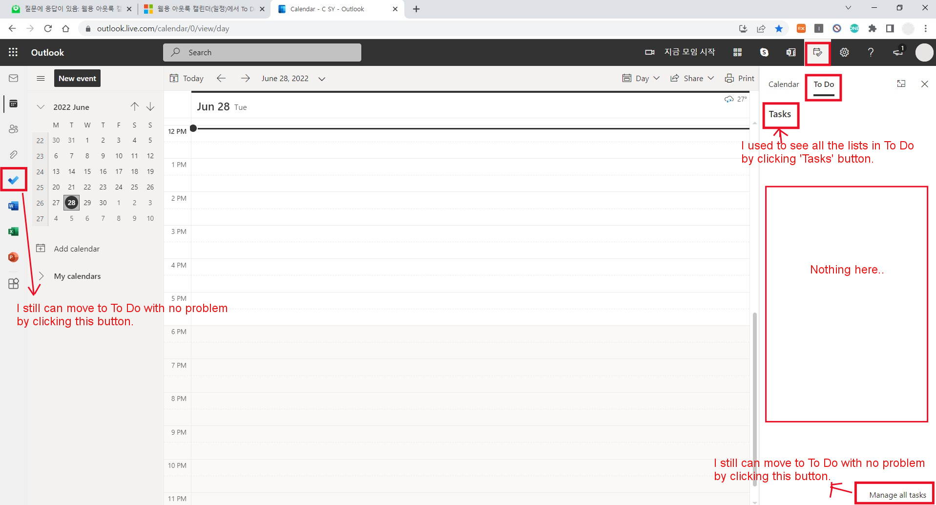

    I'm using Outlook Calendar(not outlook mail) and To Do (both web version).
    By the way, I have a problem with the Calendar not with To Do. To Do works well.
    I decided to use Outlook Calendar especially web version because on the right side bar of the Calendar I could see my lists in To Do and I don't have to switch between two websites on screen.
    I used to open the Calendar and be able to see and select all the lists in different folders in To Do by simply clicking 'My Day(at the top right corner of the screen)-To Do-Tasks' buttons.
    I don't know what I've done, but one day it only showed the list I selected the last time and no more.
    It seems like the Calendar no loner import any data from To Do.
    Other than this specific issue, I have no problem with both the Calendar and To Do.
    The Calendar and To Do are still linked under my account.
    I can move from the Calendar to To Do by clicking To Do icon on the left side bar, and once I move to To Do I can see all the lists I've made.
    I don't know what information you need more to solve the problem.
    Please find the attached picture. I hope you can help me.
    Thanks in advance.

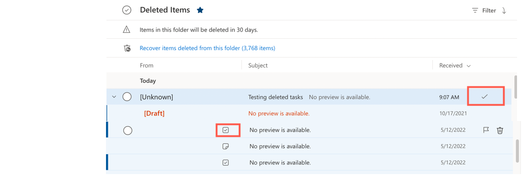

    안녕하세요 SYC,
    저는 Outlook을 전문으로하는 Office Apps & Services MVP 인 Diane이며, 오늘 당신을 도울 수있어서 기쁩니다.
    작업이 완료되었다고 표시됩니까? 삭제 된 항목 폴더에서 쉽게 찾을 수 있습니다 ... 지운 편지함을 열고 받은 열에 체크 표시가 있는 모든 항목을 삭제합니다. 삭제 된 항목에서 삭제하면 다시 돌아 오지 않아야합니다.
    대화 그룹화를 사용하는 경우 '[알 수 없음]' 아래에 함께 그룹화될 수 있습니다. 작업에 작업 아이콘이 있거나 알 수 없는 그룹 전체를 삭제할 수 있습니다.
