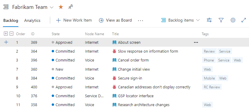

The product backlog is your project plan, which shows what your team intends to deliver. It contains user stories, backlog items, or requirements that you add to it. Your backlog is a flat list of work items, as the following image illustrates, which shows a Scrum process for Azure Boards. For the Agile, Basic, and Capability Maturity Model Integration (CMMI) process models, the Backlog items selection appears as Stories, Issues, and Requirements.
Screenshot of a Backlog of Scrum process product backlog items.

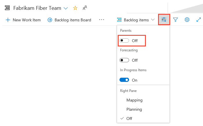

  1. Before you add work items, select View options and turn the slider for Parents and Forecasting to Off. Optionally, turn In Progress Items on or off.
    Screenshot of view options parents turned off.
