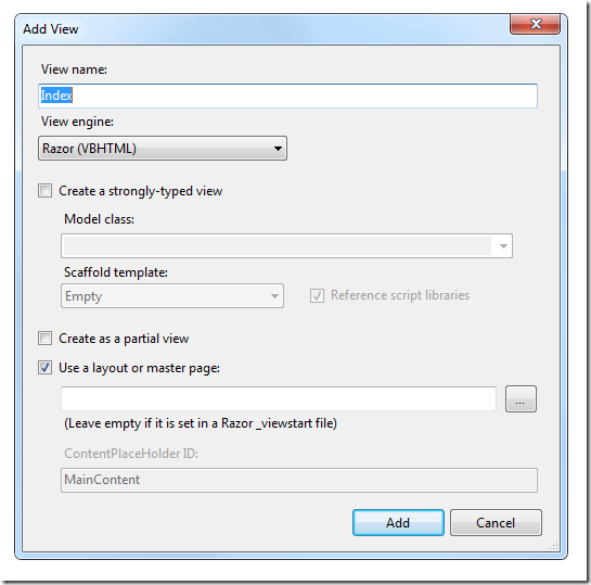

Let's now add a view template to our project that we can invoke with the Index method. To do this, right-click inside the Index method and click Add View.
IndexAddView
The Add View dialog box appears. Leave the default entries and click the Add button.

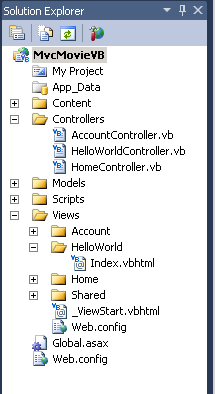

The MvcMovie\Views\HelloWorld folder and the MvcMovie\Views\HelloWorld\Index.vbhtml file are created. You can see them in Solution Explorer:

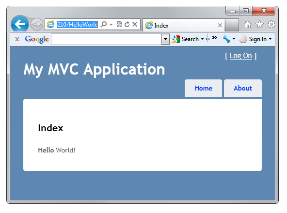

Run the application and browse to the "hello world" controller (http://localhost:xxxx/HelloWorld). The Index method in your controller didn't do much work; it simply ran the statement return View(), which indicated that we wanted to use a view template file to render a response to the client. Because we did not explicitly specify the name of the view template file to use, ASP.NET MVC defaulted to using the Index.vbhtml view file within the \Views\HelloWorld folder. The image below shows the string hard-coded in the view.
3HelloWorld
Looks pretty good. However, notice that the browser's title bar says "Index" and the big title on the page says "My MVC Application." Let's change those.

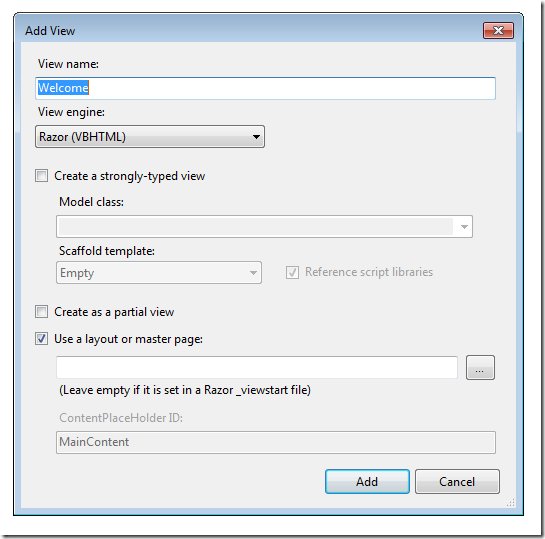

Now we need a WelcomeView template! Run the application so the new code is compiled. Close the browser, right-click inside the Welcome method, and then click Add View.
Here's what your Add View dialog box looks like.
3AddWelcomeView
