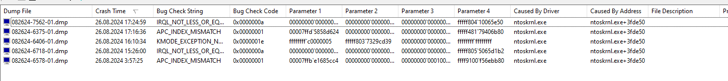

Постоянные синие экраны из-за ntoskrnl.exe
Постоянно синие экраны с разными ошибками. В утилите BluesreenView пишет, что вызывает ошибку файл ntoskrnl.exe https://learn-attachment.microsoft.com/api/attachments/d0468f3b-376a-46c9-a012-0ef6fa2cf4fe?platform=QnA&fud_access=hC1SxZhn7m%2FZQJkOIiOVstu10yTQgXS4A%2FDBzZTg8nbaCgIogkrcDydMeI5Y4za2dOqDdWtsG2JNS3E35V60i9TiGHR7STMpJHheeXuDvO8nwjUlqCBHhJ0NDvuYN7OSO6g0oVd%2FGPZGf1MtLKsqsgXLt1fy7L1o5nyy1UagHvo%2B3ZBMVheCW8Zn6xdTE%2F1d3sCVuzWC%2FTo7xVwfV%2B38GJxFgKU%2BdrLoJPmV91qVAdyFhkugpTRa9f%2BBF26ywznyt3oVtRfjuqTC89A2NnFCxbwO2y9IJM%2BXeNyRSL125qvrnGVfaQaL3SqMCx5W4CsLQLGOiTe6eT8f%2FZVjRme%2FhJfCdJDxwqBNXhgO5I8Y88dhp%2FZUwmCedRM%2FxUog690UpGGsvn7EqA82tQ5XLvrOycAvUvEeSrbqiB7k6CAFC7w%3D
В просмотре событий пишет источник kernel power
Помогите избавиться с этой проблемой. Буду очень благодарен.

Alexandr S 106.9K Баллы репутации Независимый помощник
2024-08-26T12:06:43+00:00 [082624-7609-01.dmp]
UNEXPECTED_KERNEL_MODE_TRAP (7f)
This means a trap occurred in kernel mode, and it's a trap of a kind
that the kernel isn't allowed to have/catch (bound trap) or that
is always instant death (double fault). The first number in the
BugCheck params is the number of the trap (8 = double fault, etc)
Consult an Intel x86 family manual to learn more about what these
traps are. Here is a *portion* of those codes:
If kv shows a taskGate
use .tss on the part before the colon, then kv.Else if kv shows a trapframe
use .trap on that valueElse
.trap on the appropriate frame will show where the trap was taken (on x86, this will be the ebp that goes with the procedure KiTrap)Endif
kb will then show the corrected stack.
Arguments:
Arg1: 0000000000000008, EXCEPTION_DOUBLE_FAULT
Arg2: fffff80762690e70
Arg3: ffff8a8aa9735e90
Arg4: fffff8075f4393ab
PROCESS_NAME: explorer.exe
SYMBOL_NAME: nt!KiDoubleFaultAbort+2d2
MODULE_NAME: nt
IMAGE_NAME: ntkrnlmp.exe
IMAGE_VERSION: 10.0.19041.4717
AILURE_BUCKET_ID: 0x7f_8_nt!KiDoubleFaultAbort
[082624-7562-01.dmp]
IRQL_NOT_LESS_OR_EQUAL (a)
An attempt was made to access a pageable (or completely invalid) address at an
interrupt request level (IRQL) that is too high. This is usually
caused by drivers using improper addresses.
If a kernel debugger is available get the stack backtrace.
Arguments:
Arg1: 00000000000000e1, memory referenced
Arg2: 000000000000000d, IRQL
Arg3: 0000000000000000, bitfield :
bit 0 : value 0 = read operation, 1 = write operation bit 3 : value 0 = not an execute operation, 1 = execute operation (only on chips which support this level of status)Arg4: fffff80410065e50, address which referenced memory
PROCESS_NAME: System
MODULE_NAME: nt
FAILURE_BUCKET_ID: AV_nt!HalpTimerGetInternalData
[082624-7484-01.dmp]
ATTEMPTED_WRITE_TO_READONLY_MEMORY (be)
An attempt was made to write to readonly memory. The guilty driver is on the
stack trace (and is typically the current instruction pointer).
When possible, the guilty driver's name (Unicode string) is printed on
the BugCheck screen and saved in KiBugCheckDriver.
Arguments:
Arg1: fffff8067dfb69c0, Virtual address for the attempted write.
Arg2: 0900000003db6121, PTE contents.
Arg3: fffff8067f682db0, (reserved)
Arg4: 000000000000000a, (reserved)
***** Debugger could not find nt in module list, module list might be corrupt, error 0x80070057.
MODULE_NAME: Unknown_Module
IMAGE_NAME: Unknown_Image
FAILURE_BUCKET_ID: CORRUPT_MODULELIST_AV
[082624-7468-01.dmp]
Arguments:
Arg1: 0000000000000000, memory referenced
Arg2: 0000000000000002, IRQL
Arg3: 0000000000000001, bitfield :
bit 0 : value 0 = read operation, 1 = write operation bit 3 : value 0 = not an execute operation, 1 = execute operation (only on chips which support this level of status)Arg4: fffff8027f45d1b2, address which referenced memory
PROCESS_NAME: chrome.exe
MODULE_NAME: dxgmms2
IMAGE_NAME: dxgmms2.sys
FAILURE_BUCKET_ID: AV_dxgmms2!VidSchIsVSyncEnabled
[082624-6406-01.dmp]
KMODE_EXCEPTION_NOT_HANDLED (1e)
This is a very common BugCheck. Usually the exception address pinpoints
the driver/function that caused the problem. Always note this address
as well as the link date of the driver/image that contains this address.
Arguments:
Arg1: ffffffffc0000005, The exception code that was not handled
Arg2: fffff8037329cd39, The address that the exception occurred at
Arg3: 0000000000000000, Parameter 0 of the exception
Arg4: ffffffffffffffff, Parameter 1 of the exception
MODULE_NAME: nt
FAILURE_BUCKET_ID: AV_R_nt!MiDecommitPages
[082624-6375-01.dmp]
APC_INDEX_MISMATCH (1)
This is a kernel internal error. The most common reason to see this
BugCheck is when a filesystem or a driver has a mismatched number of
calls to disable and re-enable APCs. The key data item is the
Thread->CombinedApcDisable field. This consists of two separate 16-bit
fields, the SpecialApcDisable and the KernelApcDisable. A negative value
of either indicates that a driver has disabled special or normal APCs
(respectively) without re-enabling them; a positive value indicates that
a driver has enabled special or normal APCs (respectively) too many times.
Arguments:
Arg1: 00007ffd5858d624, Address of system call function or worker routine
Arg2: 0000000000000000, Thread->ApcStateIndex
Arg3: 0000000000000001, (Thread->SpecialApcDisable << 16) | Thread->KernelApcDisable
Arg4: fffff48179406b80, Call type (0 - system call, 1 - worker routine)
PROCESS_NAME: Discord.exe
26 errors : !USBXHCI (контроллер узла USB 3.0)
MODULE_NAME: memory_corruption
IMAGE_NAME: memory_corruption
MEMORY_CORRUPTOR: LARGE
FAILURE_BUCKET_ID: MEMORY_CORRUPTION_LARGE
_______________________________________________________
BIOS Version F64
BIOS Release Date 06/08/2023
Manufacturer Gigabyte Technology Co., Ltd.
Product Name B450M S2H
Processor Version AMD Ryzen 5 3500X 6-Core Processor
Processor Voltage 8bh - 1.1V
External Clock 100MHz
Max Speed 4100MHz
Current Speed 3600MHz
Memory Device:
Size 8192MB
Form Factor 09h - DIMM
Device Locator DIMM 1
Bank Locator P0 CHANNEL A
Memory Type 1ah - DDR4
Speed 2400MHz
Manufacturer Kingston
Part Number KHX3000C15D4/8GX
Configured Memory Speed 2400
Minimum Voltage 1200
Maximum Voltage 1200
Configured Voltage 1200
Size 8192MB
Bank Locator P0 CHANNEL B
Speed 2400MHz

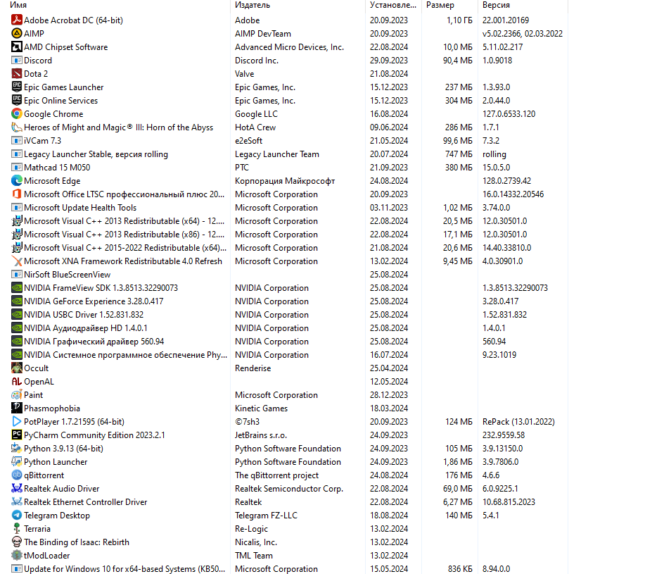

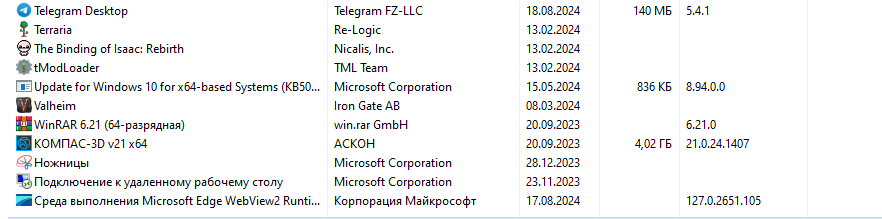

Проблемы с ядром ОС, с памятью и локально с API DirectX.
Выложите здесь скриншоты:
- Окна Панель управления-Программы и компоненты со списком всех установленных программ.

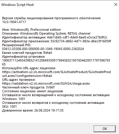

- Окна команды slmgr.vbs /dlv
