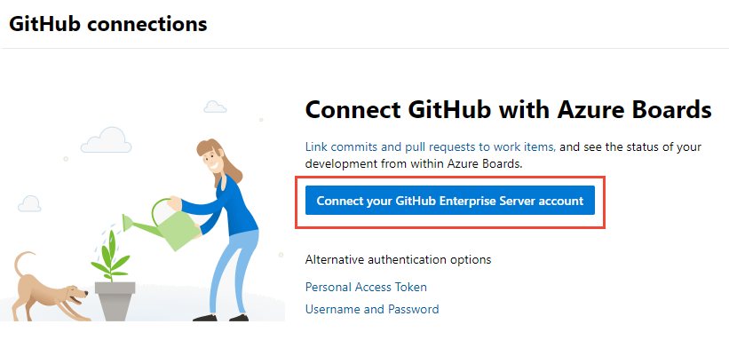

  3. Select Project settings > GitHub connections.
    Screenshot of open Project Settings, GitHub connections.
  4. If it's your first time making a connection from the project, choose the authentication method you want to use to make the connection:
    Screenshot of first time connecting with GitHub credentials.
    Otherwise, select New connection, and the select your authentication method from the New Connection dialog.

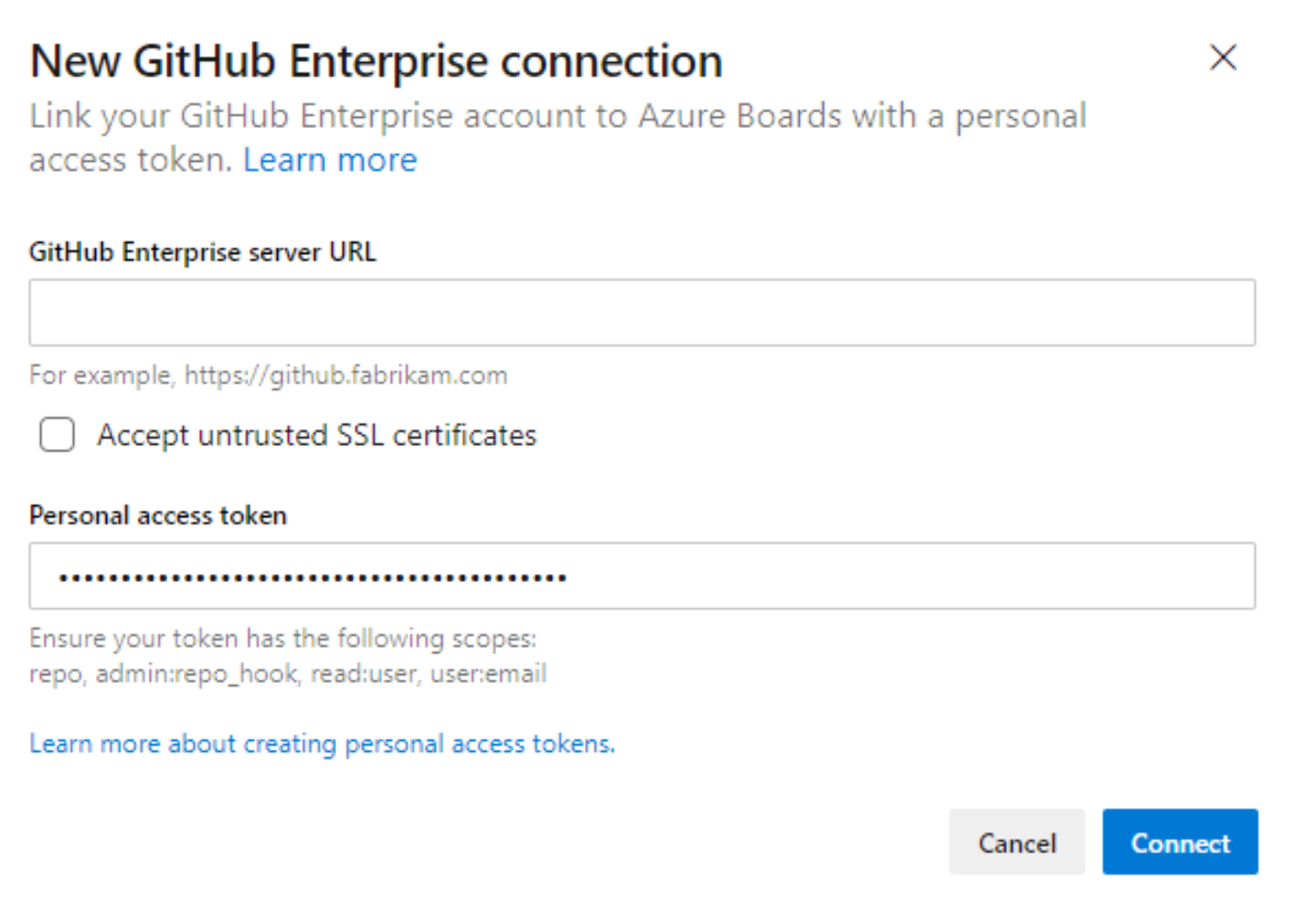

Connect Azure DevOps Server with a GitHub Personal Access Token
  1. To create a GitHub PAT, see Create a GitHub PAT.
    Tip
    When you create your GitHub PAT, make sure that you include these scopes: repo, admin:repo_hook, read:user, user:email.
  2. Enter the URL for your GitHub Enterprise server and the Personal access token credentials recognized by that server. And then select Connect.
    Screenshot of sign in with GitHub PAT.

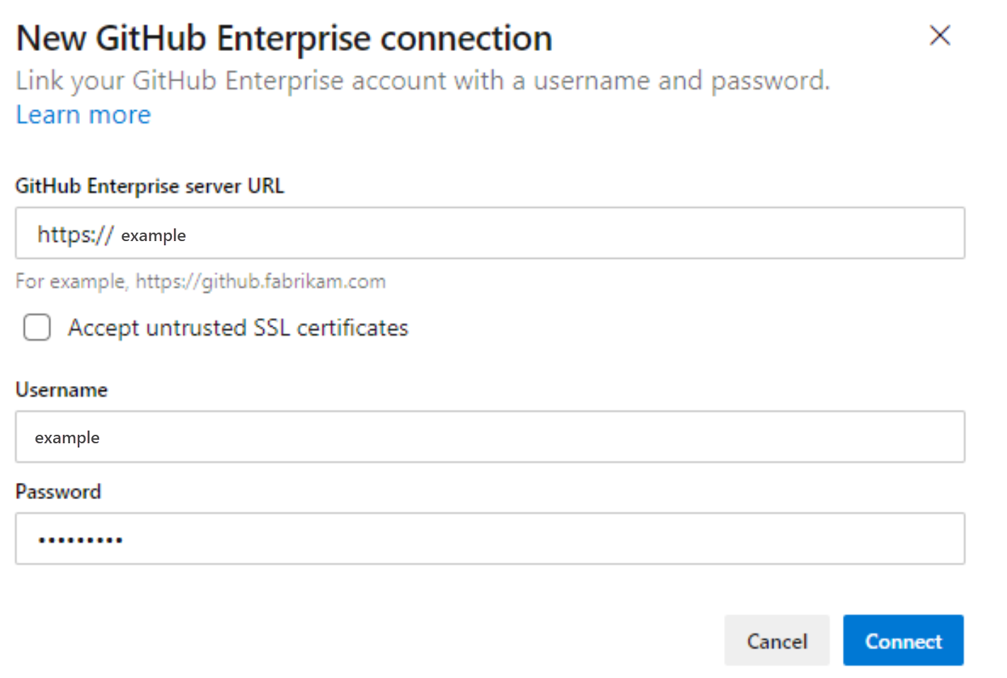

Connect Azure DevOps Server with GitHub credentials
  1. Enter the URL for your GitHub Enterprise server and the administrator account credentials recognized by that server. And then choose Connect.
    Screenshot of sign in with GitHub credentials.

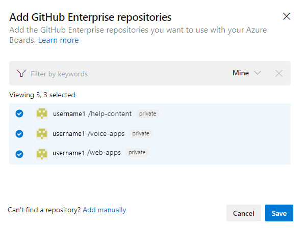

  2. The dialog lists all repositories for which you have GitHub administration rights. You can toggle between Mine and All to determine if others appear, and then check the ones that you want to add. Choose Save when you're done.
    Screenshot of repositories to select to add.
  3. To connect to a GitHub account or organization from Azure Boards for the first time, you also install the Azure Boards app for GitHub. Complete the integration by following the procedures outlined in Confirm the connection.
