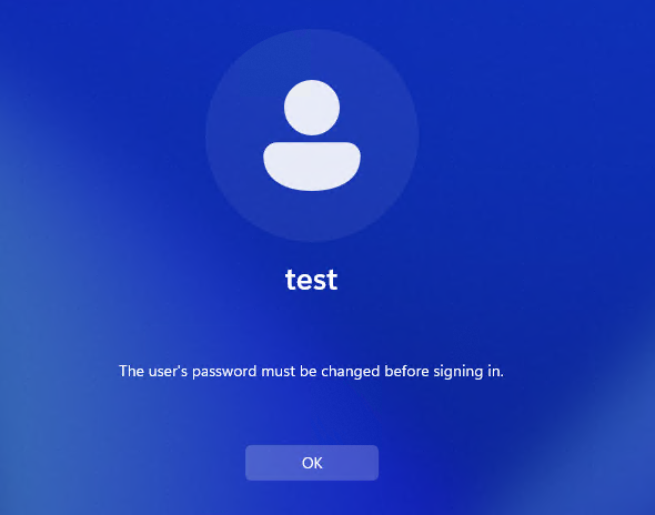

Hello, I have a problem. I installed Windows Server 2025 and DNS, DHCP, and Active Directory roles on it. I have a domain and a computer connected to it. When I log in to the client with a domain account, everything works, and the user logs in. When I enable the option "User must change password at next logon", and I try to log in, I am prompted to change the password, but when I enter a new password (which meets the conditions), the system tells me that the user must change the password.
Obrázek uživatele
I am really desperate. I set the password age to 0. The time is synchronized, the user can log in at any time and change the password via the ctrl + alt + delete menu. But as soon as I force the change via AD, it is not possible.

    I think I found the problem. My server was missing the KB5065426 update (OS Build 26100.6584), which solved the issue.
