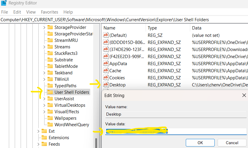

    3.Using Registry Editor (If Desktop Reset Fails):
    1. Open Task Manager (Ctrl + Shift + Esc).
    2. Go to File > Run new task > Type regedit > Check "Create this task with admin privileges" > OK.
    3. Navigate to: HKEY_CURRENT_USER\SOFTWARE\Microsoft\Windows\CurrentVersion\Explorer\User Shell Folders
    4. Double-click the Desktop entry in the right pane.
    5. Change its value data to: %USERPROFILE%\Desktop Benutzerbild
    6. Restart your PC.
