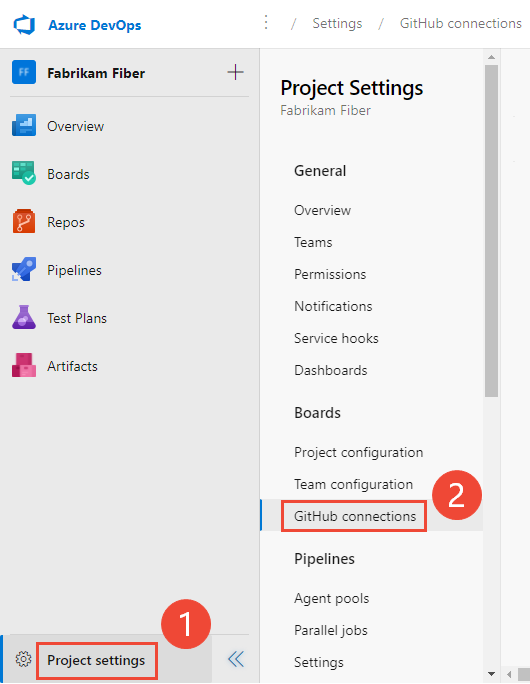

  1. Sign in to your project (https://dev.azure.com/{Your_Organization/Your_Project}).
  2. Select Project settings > GitHub connections.
    Screenshot of open Project Settings>GitHub connections.

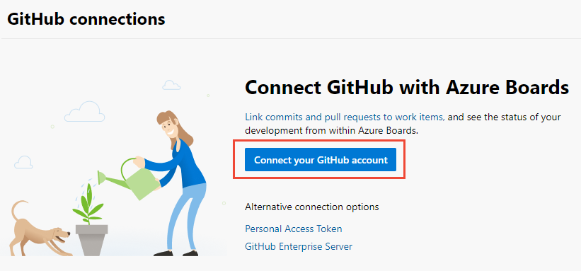

  3. For a first-time connection, select Connect your GitHub account to authenticate with your GitHub credentials.
    Screenshot of first time connecting with GitHub credentials.

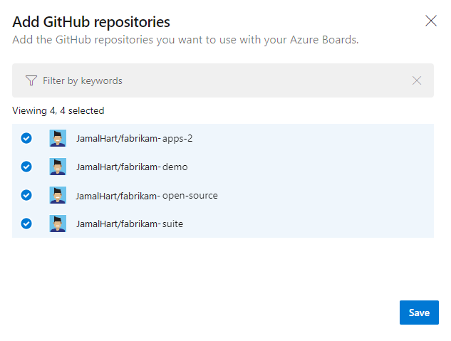

  1. The Add GitHub Repositories dialog displays and preselects all repositories where you're an administrator in the selected organization. Clear any repositories you don't want to connect.
    Screenshot showing GitHub repos.

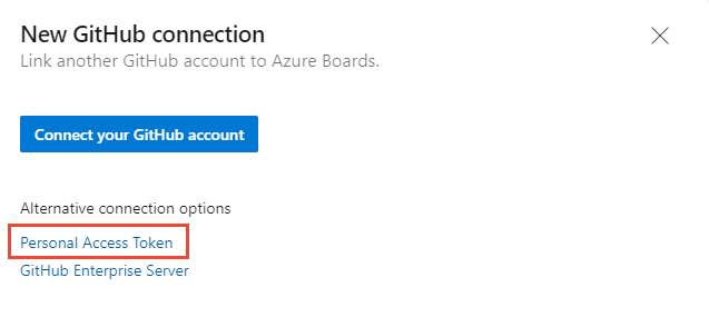

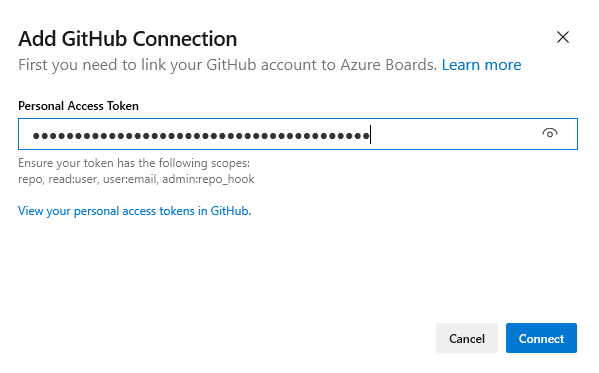

  1. Select Personal Access Token in the New Connection dialog.
    Screenshot of New GitHub connection dialog, choosing Personal Access Token.
    To create a GitHub PAT, go to GitHub Developer Settings > Personal access tokens.
  2. Enter the PAT and select Connect.
    Screenshot showing entered PAT.

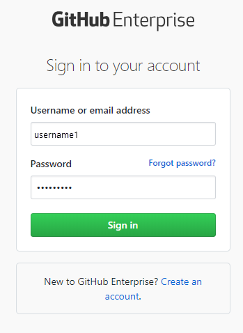

  1. Sign in to the web portal for your GitHub Enterprise Server.
    Screenshot of sign in for GitHub Enterprise server.

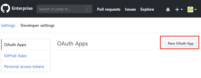

  2. Open Settings > Developer settings > Oauth Apps > New OAuth App.
    Screenshot showing sequence for New OAuth App.

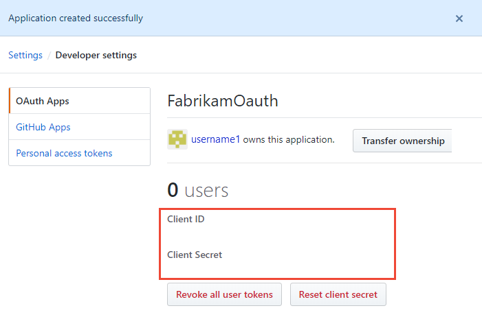

  5. Copy the Client ID and Client Secret that appear for your registered OAuth application.
    Screenshot of Client ID and Client Secret for the registered OAuth application.

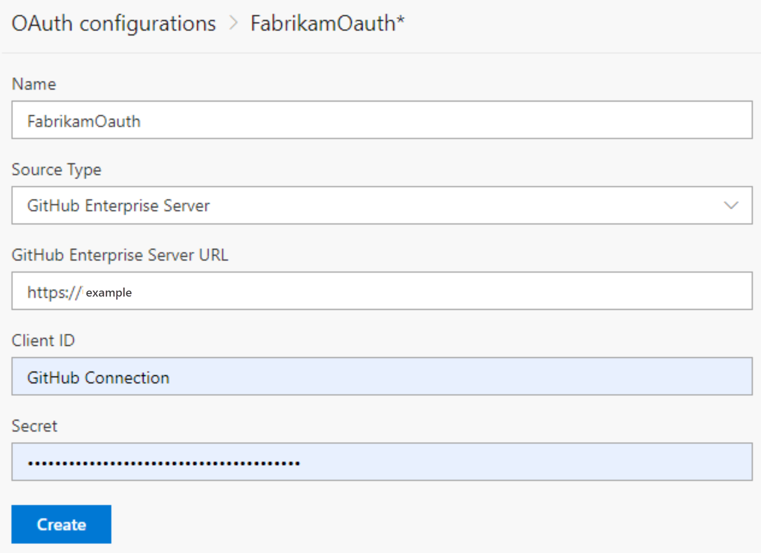

Register your OAuth configuration in Azure DevOps Services
  1. Sign in to the web portal for Azure DevOps Services.

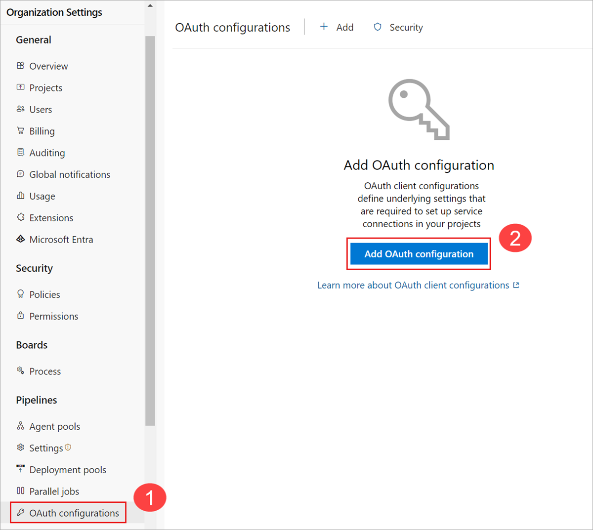

  2. Select Organization settings > Oauth configurations > Add Oauth configuration.
    Screenshot of Open Organization Settings, OAuth configurations.
  3. Enter your information and select Create.
    OAuth configurations dialog.

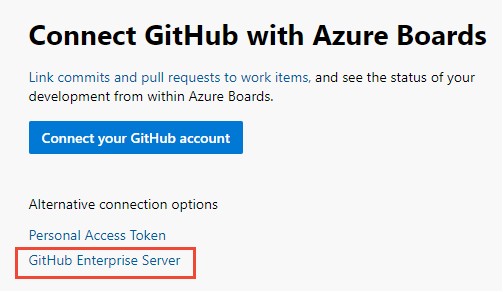

  1. Select Project settings > GitHub connections > GitHub Enterprise Server for a first-time connection.
    First connection, GitHub Enterprise Server option.

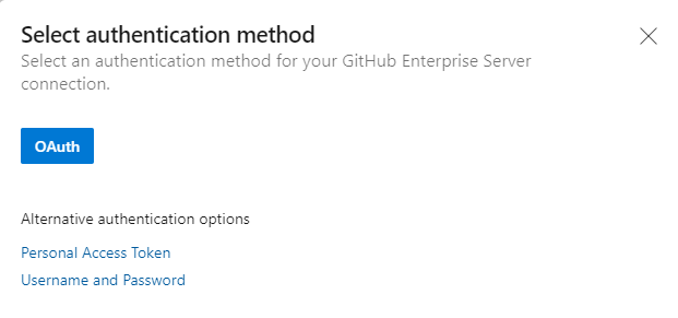

  2. Select the authentication method.
    Screenshot showing authentication method dialog.

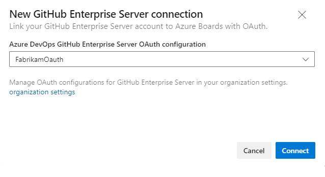

    Connect with OAuth — Select the OAuth configuration you registered in Register your OAuth configuration, then select Connect.
    Screenshot of New GitHub Enterprise connection, OAuth connection dialog.

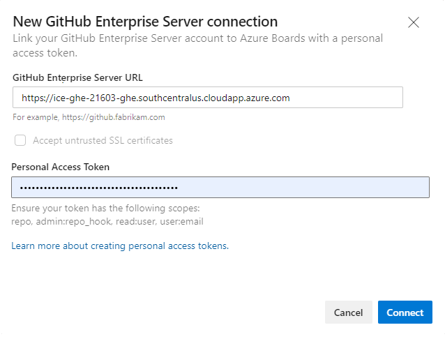

    Connect with a Personal Access Token — Enter your GitHub Enterprise Server URL and PAT, then select Connect.
    Screenshot of New GitHub Enterprise connection, Personal access token connection dialog.

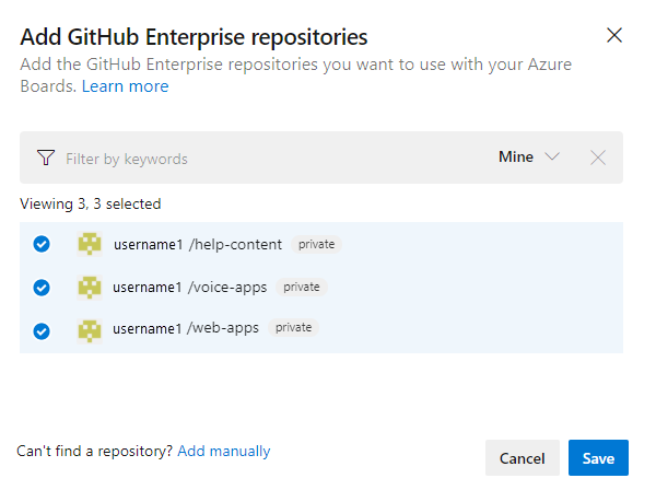

  3. The dialog lists all repositories where you have administration rights. Toggle between Mine and All to find additional repositories, select the ones to add, and then select Save.
    Screenshot of repositories listed.

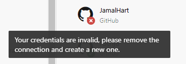

When the Azure Boards connection to GitHub loses access, a red-X alert appears in the UI. Hover over the alert to confirm the credentials are no longer valid. Remove the connection and create a new one.
Screenshot of failed connection.
  • OAuth connections:
    • Azure Boards access was denied for one of the repositories.
    • GitHub or Azure DevOps might be unreachable due to a service outage or network issue. Check status: GitHub | Azure DevOps
      Delete and recreate the connection. GitHub prompts you to reauthorize Azure Boards.
