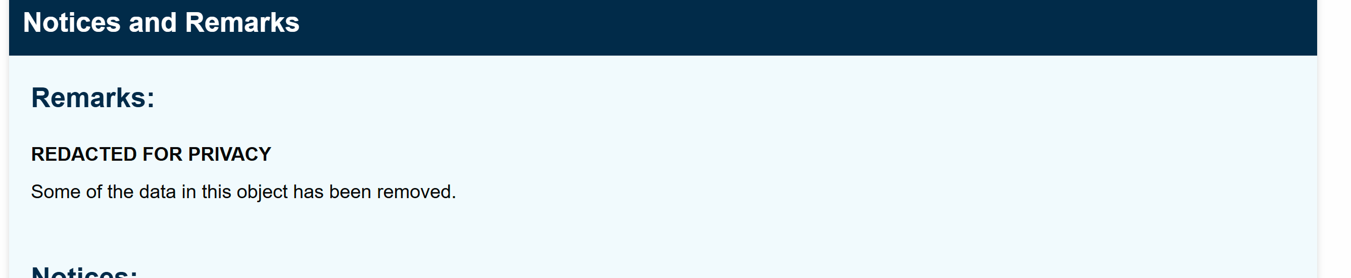

    However, i think the DNS domain gigkeeping.com is redacted by the Domain Registrar itself which seems Go daddy in your case.
    Kindly refer the below URL to check yourself.
    https://lookup.icann.org/en/lookup
                "contact-uri",
                "uri",
                "https://www.secureserver.net/whois?plid=1387&domain=gigkeeping.com"
          "roles": [
            "administrative"
          "events": [
              "eventAction": "last changed",
              "eventDate": "2024-06-29T07:40:09Z"
          "remarks": [
              "title": "REDACTED FOR PRIVACY",
              "type": "object truncated due to authorization",
              "description": [
                "Some of the data in this object has been removed."
    Hence it is advised to kindly also engage with your domain Registrar in this case.
