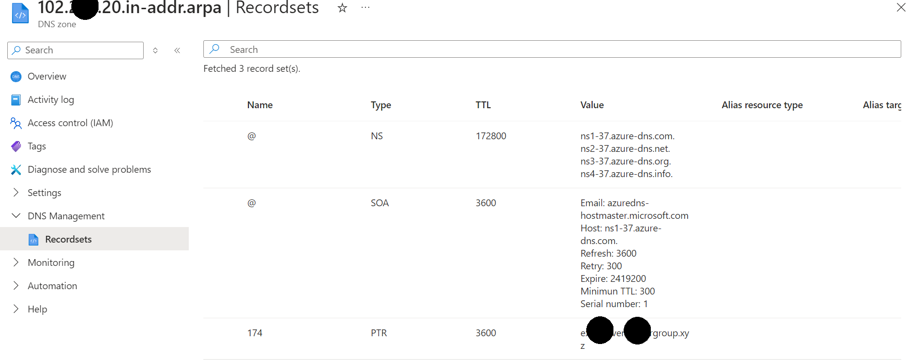

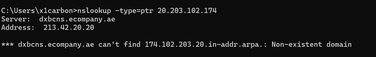

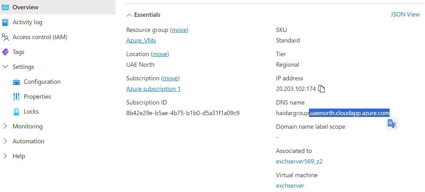

I have an issue with creating a PTR record to map an Azure public IP to my public domain name, which is hosted on Namecheap. I followed the structure described in the following link and created a reverse DNS zone using the first three octets of the public IP address. I then created a PTR record, named with the last octet of the public IP, and mapped it to my Namecheap domain name. However, after 10 hours since the creation of the PTR record, I tried to check the PTR record resolve command, and the result was "Non-existent domain":

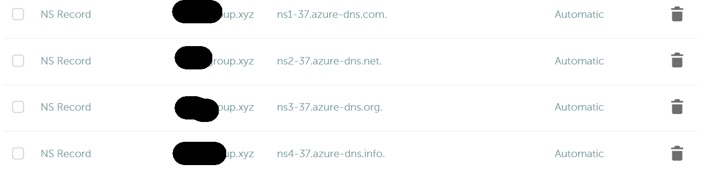

I followed every step in the link above. Additionally, I have delegated my domain by defining the Azure DNS record shown in the created reverse DNS in Namecheap DNS by adding an NS record.

    The documentation that you are following, explains how to host reverse DNS lookup zones in Azure DNS which means you can host reverse DNS lookup zones for your ISP-assigned IP blocks on Azure DNS. The IP ranges represented by the reverse lookup zones must be assigned to your organization, typically by your ISP.

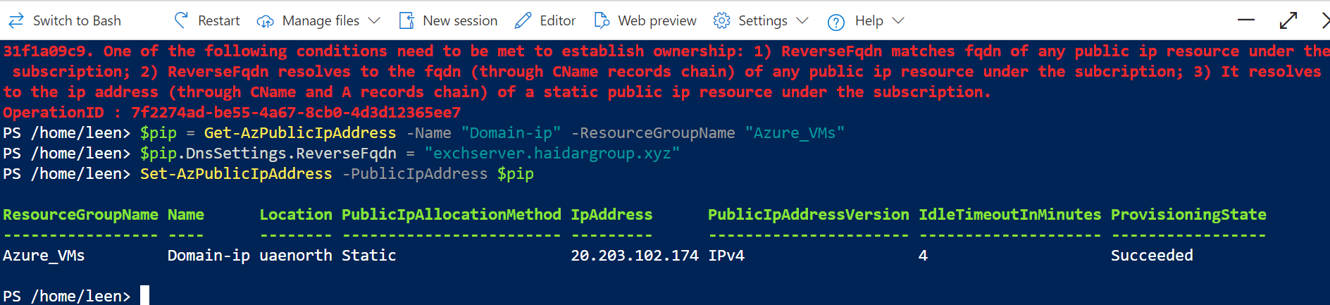

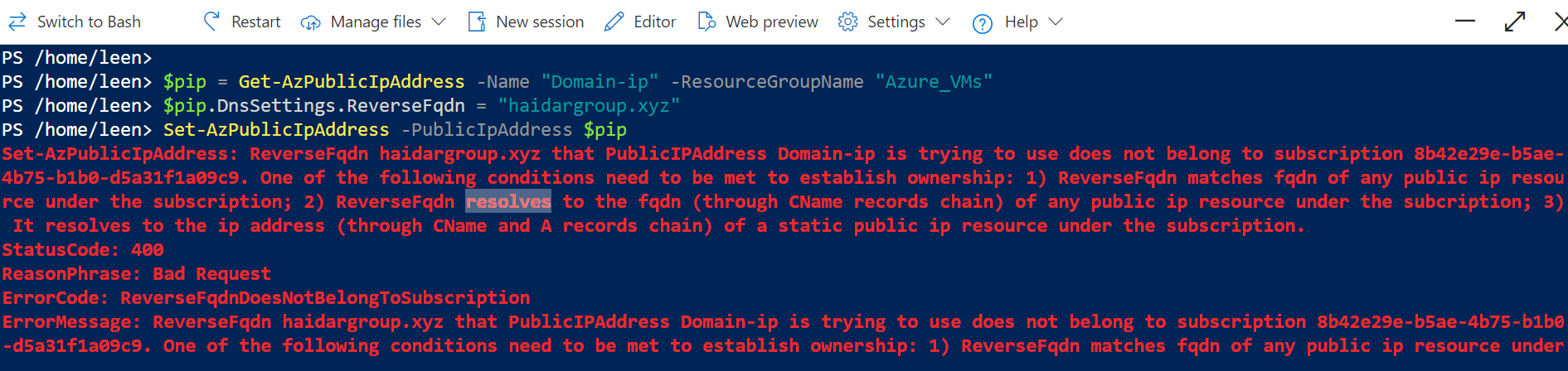

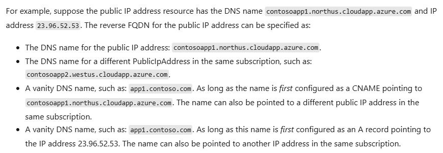

    As explained in this doc, Azure only allows the creation of a reverse DNS record where domain name specified in the reverse DNS record is the same as, or resolves to, the DNS name or IP address of a PublicIpAddress or Cloud Service in the same Azure subscription.
    NOTE: You can configure reverse DNS for PublicIpAddress resources in the Resource Manager deployment model, using either Azure PowerShell, Azure classic CLI, or Azure CLI. Configuring reverse DNS for PublicIpAddress resources is not currently supported via the Azure portal.
    To add reverse DNS to an existing PublicIpAddress, you need to make sure that the Public IP address has a DNS name.

    1. Once the DNS name of the Public IP address is configured and replicated, you will have to go to your DNS provider where your custom domain is (in your case Namecheap) and create an A record for the custom DNS to point to the Public IP address or a CNAME record pointing to the Public IP’s DNS name as below:
    1. Once the A record or CNAME record is configured & replicated, you can go ahead and set Reverse DNS as follows using the below Azure PowerShell commands:
    $pip = Get-AzPublicIpAddress -Name "VM2PublicIP" -ResourceGroupName "Training-Lab"
    $pip.DnsSettings.ReverseFqdn = "msazurelabs.tk"
    Set-AzPublicIpAddress -PublicIpAddress $pip
    It should execute successfully and give the following output:
    Name : vm2publicip ResourceGroupName : Training-Lab Location : eastus
    ProvisioningState : Succeeded Tags : PublicIpAllocationMethod : Static
    IpAddress : 52.168.167.212 PublicIpAddressVersion : IPv4 IdleTimeoutInMinutes : 4
    IpConfiguration : { "Id": "/subscriptions/xxxxxxxxxxxxxxxxxxxxxxxx/resourceGroups/Training-Lab/providers/Microsoft.Network/networkInterfaces/vm2269/ipConfigurations/ipconfig1" }
    DnsSettings : { "DomainNameLabel": "msazurelabs", "Fqdn": "msazurelabs.eastus.cloudapp.azure.com", "ReverseFqdn": "msazurelabs.tk" } Zones : {}
    Sku : { "Name": "Basic", "Tier": "Regional" } IpTags : [] ExtendedLocation : null

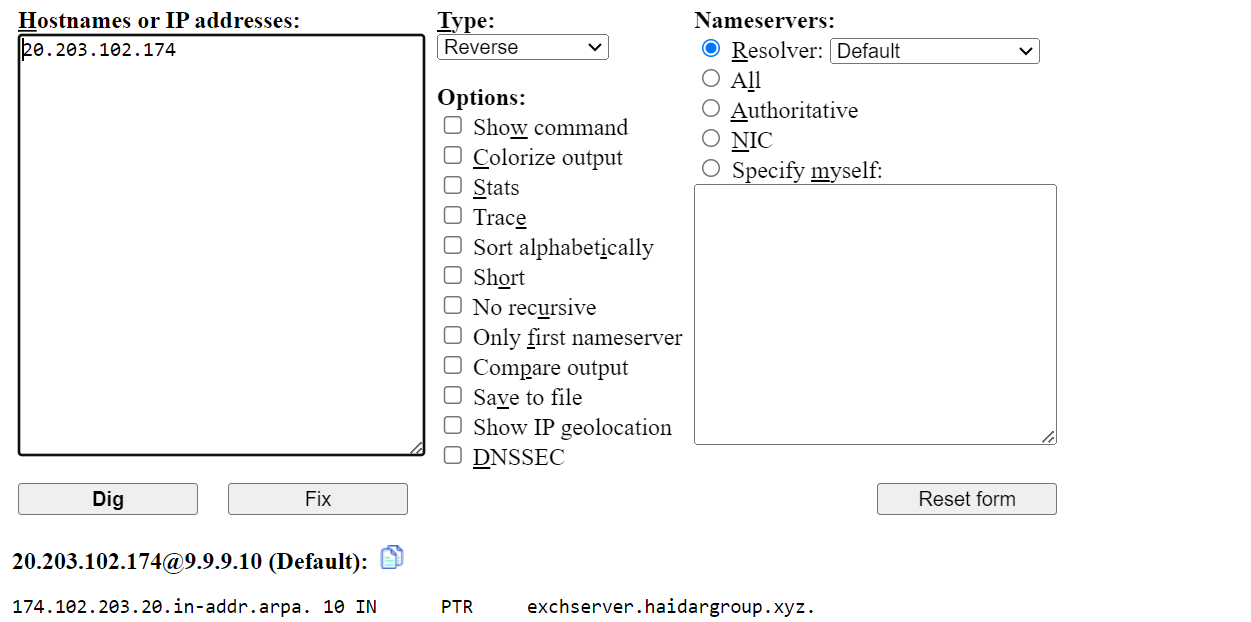

    NOTE: It may take some time to replicate the settings and then you can verify the same using Digwebinterface as below.
