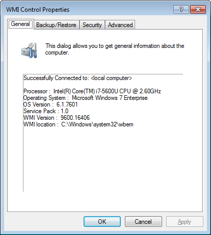

  2. MilesLindsay-4339 5 Reputation points
    2025-01-12T02:10:06.0933333+00:00
    I should add the WMI issues came about from an internal work document. in which when you right click you would
    Right‐click MY COMPUTER (on the desktop or start menu) and select [ Manage ] to open
    the COMPUTER MANAGEMENT window. On a Windows machine, right click on
    Start, then select Computer Management. But the fix provided did not work for Window systems with the condition described above.
    Fix-
    net stop ccmexec
    net stop bits
    sc config winmgmt start= disabled
    taskkill /IM CCMExec.exe /F
    net stop winmgmt /y
    net stop "tanium client"
    rd /q /s C:\Windows\system32\wbem\repository
    rd /q /s C:\Windows\softwaredistribution\Download
    md C:\Windows\softwaredistribution\Download
    rd /q /s C:\Windows\ccmcache
    md C:\Windows\ccmcache
    rd /q /s C:\Windows\ccm\temp\
    md C:\Windows\ccm\temp\
    rd /q /s C:\Windows\CCM\Staging\
    md C:\Windows\CCM\Staging\
    rd /q /s C:\Windows\CcmTemp\
    sc config winmgmt start= auto
    net start iphlpsvc
    net start wscsvc
    net start winmgmt
    sc config ccmexec start= delayed‐auto
    mofcomp "c:\program files\microsoft policy platform\extendedstatus.mof"
    net start ccmexec
