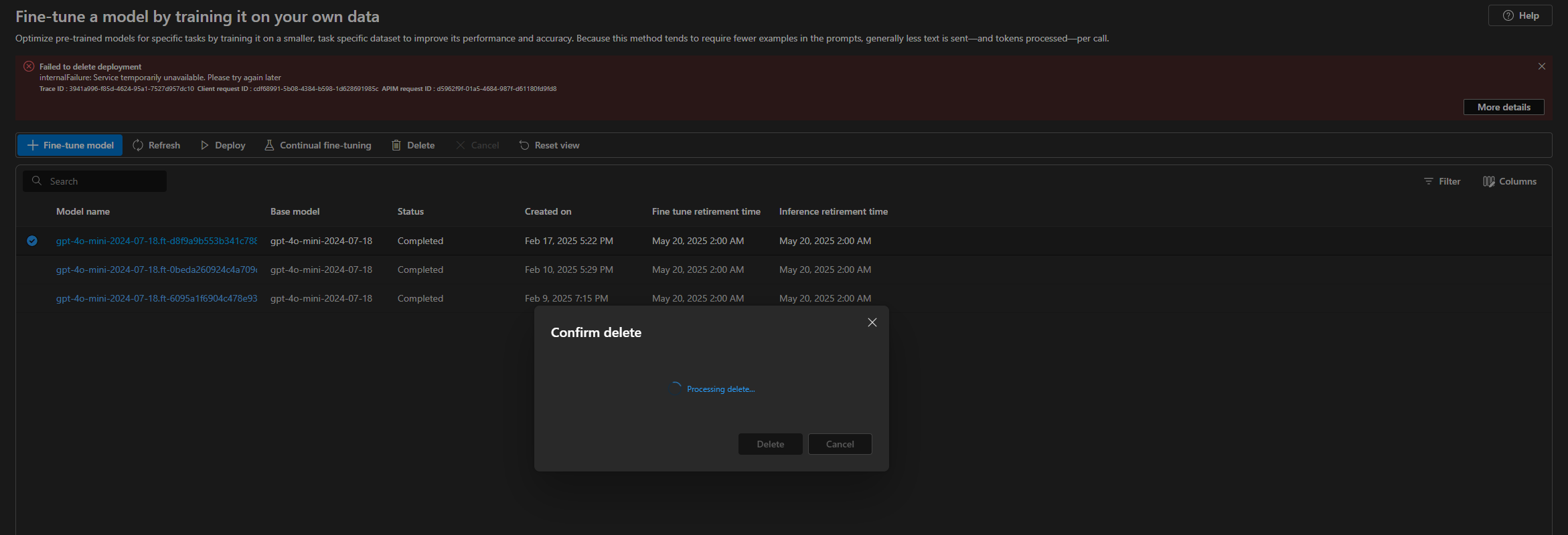

Why am i not able to delete a finetune job in azure openAI
Ghaith Almasri 20 Reputation points
2025-02-19T09:15:19.21+00:00
When I attempt to delete a finetune job I get an error, even the API endpoing is not working for me. What could be the reason?
{ "error": { "code": "internalFailure", "message": "Service has failed unexpectedly, retrying may help. RequestId:d5962f9f-01a5-4684-987f-d61180fd9fd8" } }
internalFailure
PropertiesStack traceError: Request failed with status code 500 at ht (https://ai.azure.com/assets/manualChunk_data-fetch-bd489cf3.js:14:85613) at dt (https://ai.azure.com/assets/manualChunk_data-fetch-bd489cf3.js:14:85796) at XMLHttpRequest.S (https://ai.azure.com/assets/manualChunk_data-fetch-bd489cf3.js:15:1655)Target-Client request IDcdf68991-5b08-4384-b598-1d628691985cTrace ID3941a996-f85d-4624-95a1-7527d957dc10Service request ID-APIM request IDd5962f9f-01a5-4684-987f-d61180fd9fd8

    Hi @Ghaith Almasri,
    The error message you are encountering, "internalFailure", indicates that the Azure OpenAI service has failed unexpectedly. This is often a temporary issue, and retrying the request after some time may resolve it. Ensure that you are attempting to delete the correct resource.
    Deleting a fine-tuned model's deployment does not delete the model itself, you can re-deploy it later. You can try deleting the deployment via the Azure AI Foundry portal, via REST API, Azure CLI, or other supported methods. If you are still unable to delete the job, verify that you have the necessary Cognitive Services OpenAI Contributor role assigned, as even high-level service administrators require this explicit permission for fine-tuning actions.
    Please refer to: Delete Fine-tune models.
