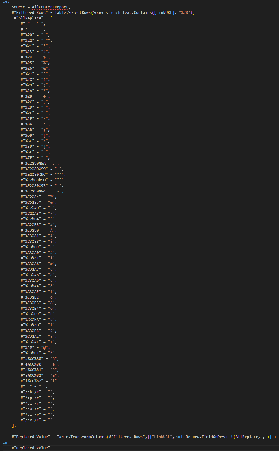

I am trying to do a mass find and replace within Power Query to avoid having to create individual steps for each replacement. I had previously researched this and used the solution here and it worked but due to the length of the replace and how often it is used, it does not make sense to recreate it each time, so I pasted it into OneNote for later reference.
Now, each time that I try to use the code, it won't work. Thinking that it might be some invalid character from OneNote messing it up, I paste it into Visual Studio to ensure the code looks good and no invalid characters were added.
Source data is exactly the same, just the data within the actual table is updated to match the most up to date information from the system.
Due to the security of the content, I am unable to share the source file but I am able to attach the Power Query M code (Mass Replace.txt).
What am I missing?
Column name:
Code for reference:

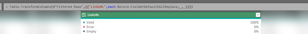

    Based on your sharing, the issue highly comes from the variable definition in your code #"Replaced Value" = Table.TransformColumns(#"Filtered Rows", {{"LinkURL", each Record.FieldOrDefault(AllReplace, _, _)}}). When defining, you used #"AllReplace" but in the code you referenced AllReplace, which leading to using unknown AllReplace variable before you defined it.
    I suggest you can try fixing the variable name from
    #"AllReplace" = [
    // Your entire replacement record
    To
    AllReplace = [
    Then you can check again to see if the query works properly.

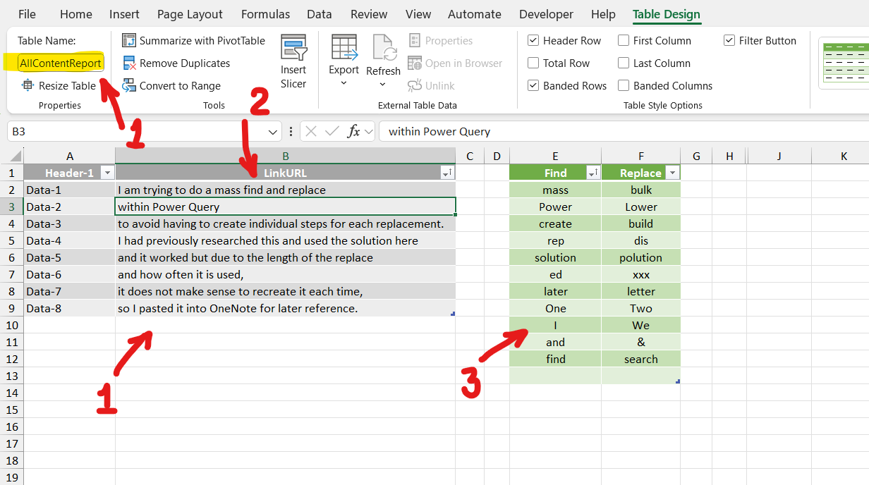

    To mimic or partially reproduce your scenario,
    1. Let's rename the Source table as "AllContentReport". (as the name on your table query).
    2. Similarly, let's rename the column we want to replace the values in as "LinkURL"

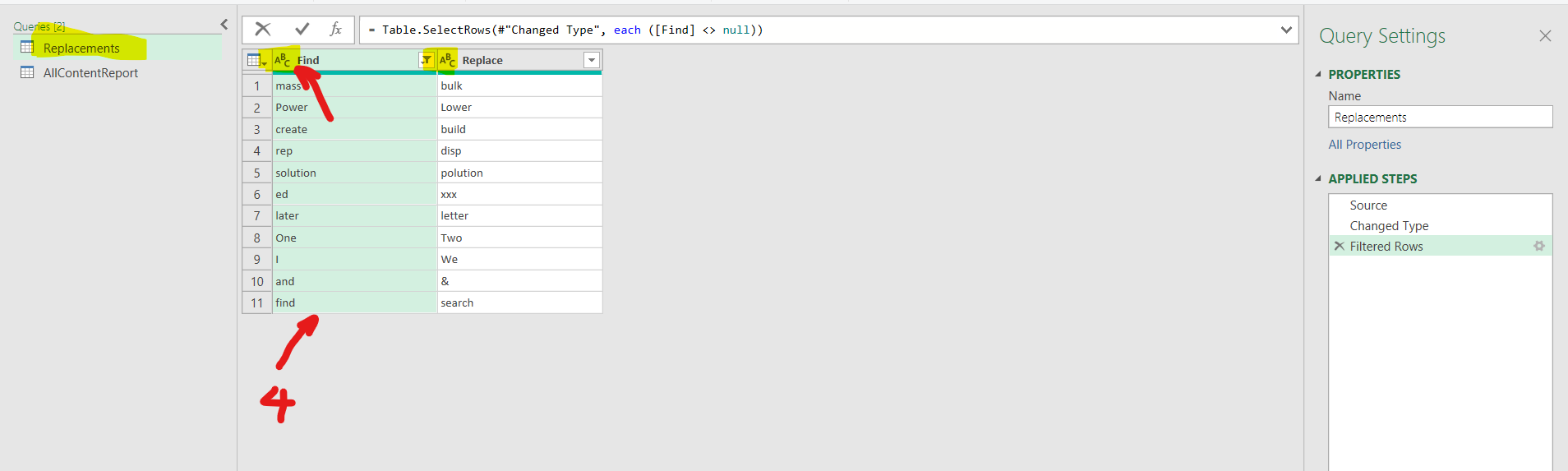

    3. In the Replacement Table (in Green), we enter the values to find and replace, respectively. User's image Once the Tables are uploaded to PQ.
    4. Make sure the Replacement table columns and the "LinkURL" column are formatted as "Text". Also, filter out "Null" rows in the Replacement table.
    1. Select the "AllContentReport" source table >> Go to the Add Column Tab and "Add Custom Column" with the following formula.
    List.Accumulate(
        List.Numbers(0, Table.RowCount(Replacements)),
        [LinkURL],
        (state, current) =>
        Text.Replace(state, Replacements[Find]{current}, Replacements[Replace]{current}))
    Where "Replacements" refers to the same-named table.
    NOTE: Based on the picture below, you must be adding the custom column step after filtering your Source table.
    1. Then simply, remove the (old) "LinkURL" column and rename the "Custom1" column as per your needs.
    and VOILA!!!!, JOB DONE!

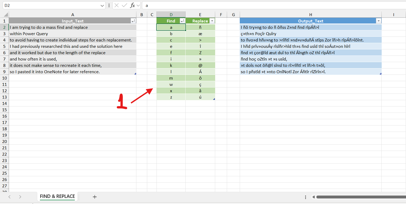

    1. This Query uses a table for listing all the words and/or characters to find, with their respective replacement values (the green table in the picture below). Then simply "Refresh" the Table
    Here is the M Code:
    let
        Source = Input_Text,
        #"Added Custom" = Table.AddColumn(Source, "Output_Text", each List.Accumulate(
        List.Numbers(0, Table.RowCount(replacements)),
        [Column1],
        (state, current) =>
        Text.Replace(state, replacements[Find]{current}, replacements[Replace]{current}))),
        #"Removed Columns" = Table.RemoveColumns(#"Added Custom",{"Column1"})
    in
        #"Removed Columns"
    Please, adapt the M code to your scenario.
