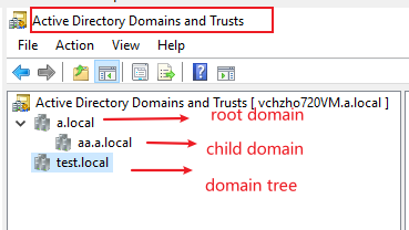

    1.Is your AD forest single forest and single domain environment or single forest and multiple domains environment?
    2.If your AD forest is single forest and multiple domains environment. How many domains are there in your AD forest?
    For example:
    3.How many DCs are there in each domain? Please run nltest /dclist:domain.com to check.
