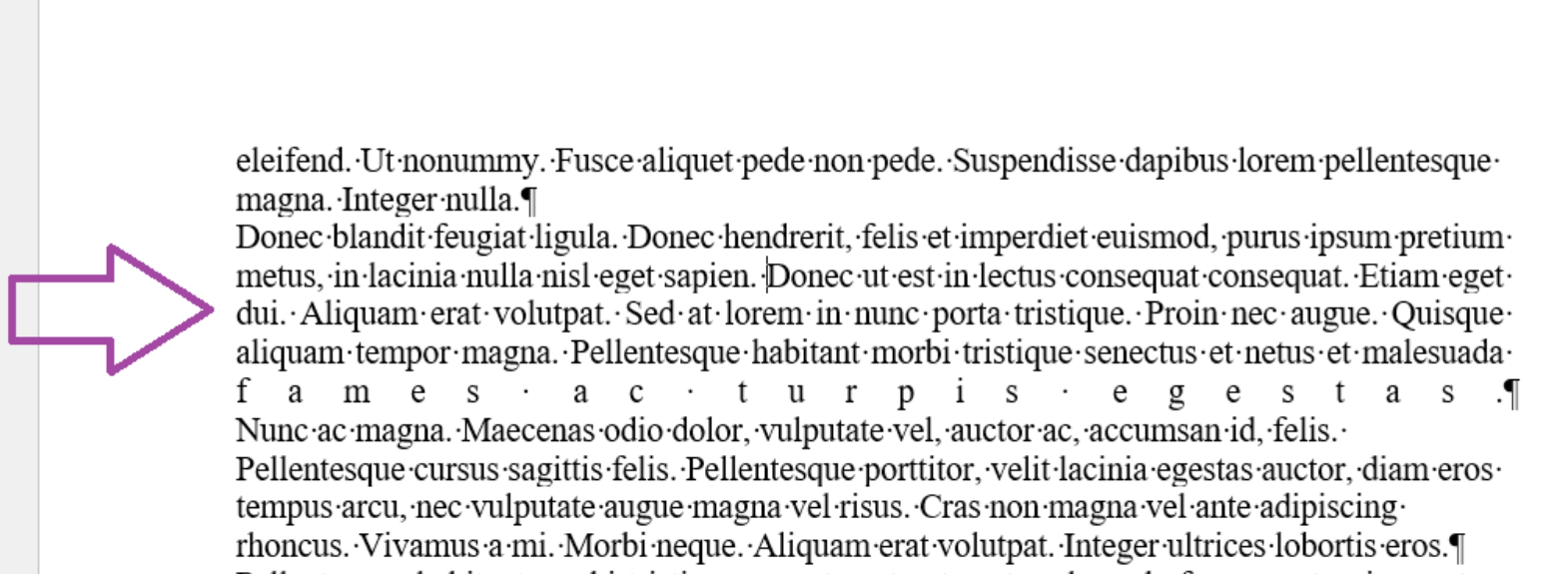

    I am wondering if you are seeing distributed alignment rather than justified? The screen shot below shows the behavior of a distributed text paragraph:
    See if you can fix it by selecting the text and then press Command+J to (re-)apply standard justified text.
