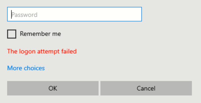

  1. Rukmini 42,515 Reputation points Microsoft External Staff Moderator
    2026-05-29T13:31:38.2466667+00:00
    @Robin Hitch
    This error can occur if you have configured a legacy per-user Enabled/Enforced Microsoft Entra multifactor authentication or the Security Defaults are active.
    To fix the issue:
    Remove the legacy per-user MFA setting or disable the Security Defaults. You can find detailed steps on how to do this in the Microsoft documentation: Disable or Enable per-user Microsoft Entra multifactor authentication to secure sign-in events,
    Providing a default level of security in Microsoft Entra ID – Microsoft Entra | Microsoft Learn.
    Resolving MFA-Related RDP Issues to Azure VMs
