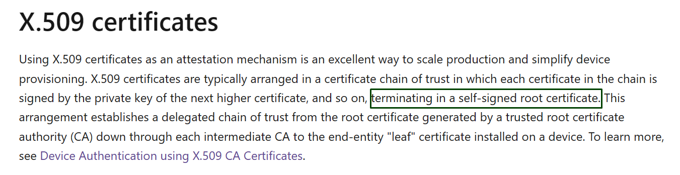

    Once you get a valid certificate from a trusted Certified Authority, the authentication for the devices will display as 'X509 CA Signed' instead of 'Self-Signed X509 Certificate'. Please refer this resource X.509 certificate attestation gives an overview of the Device Provisioning Service (DPS) concepts involved when provisioning devices using X.509 certificate attestation. The article mentions that self-signed root certificate will be terminated after providing a valid X.509 certificate.
