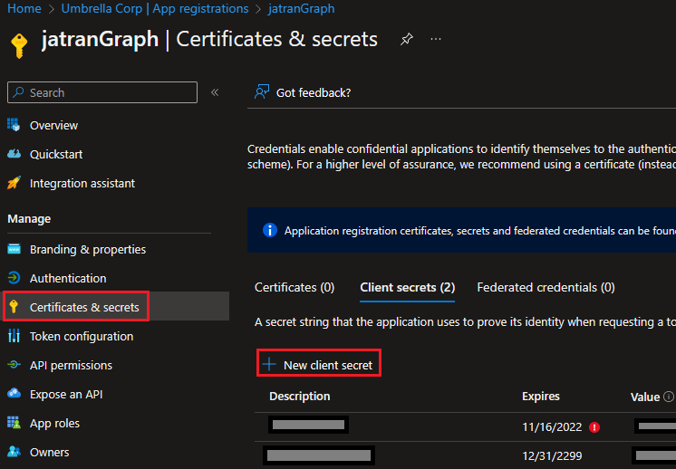

    To resolve the error, you need to sign in to Azure Portal using Global Administrator or Application Administrator account and navigate to:
    Azure Active Directory > Application Registrations > Search for ClusterServicePrincipal-todo-0002 > Under Manage section, click on Certificates & Secrets > Under client secrets, click on + New client secret as highlighted below:
    For more info - Add a client secretUser's image
    If you have specified the old secret in any your application(s), you need to update your application code with the new code.
