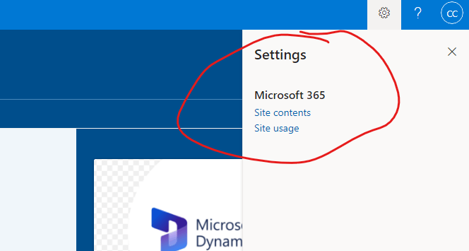

It is very important for us to somehow eliminate or hide the buttons that appear in the following screenshots, especially the "Site Contents" and "Site Usage," as they contain content that we do not want to be visible to our external users.
Also we would like to the "Sent by email button" to disappear as well. Is there a way to do that please?
Below the screen shots.

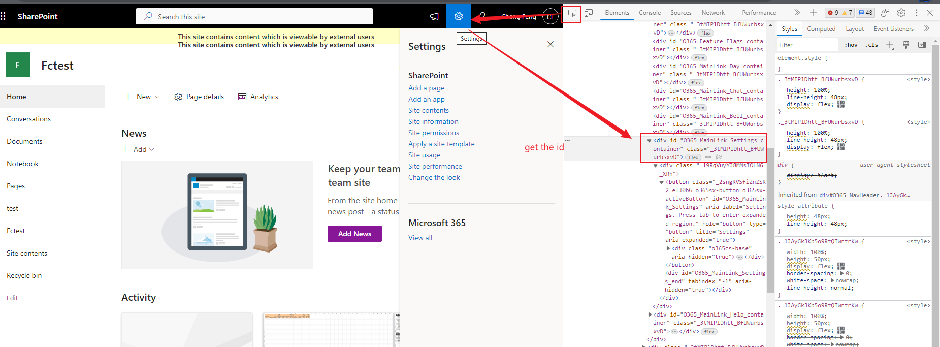

    Then arrive at the sharepoint page, press F12, open the developer mode, we need to find the ID of the icon in the page:
    Get the ID through JS code, and then remove
    Here is code:
    const canEdit = this.context.pageContext.web.permissions.hasAnyPermissions(SPPermission.manageWeb);
        if (canEdit) {
          let checkExist = setInterval(function () {
            const element = document.querySelector("#O365_MainLink_Settings_container").firstChild.firstChild.firstChild.firstChild;
              element.parentElement.parentElement.parentElement.remove();
              console.log("GFC user only has view rights.");
              clearInterval(checkExist);
          }, 100);
    Finally execute the SPfx extension
    Here is result:

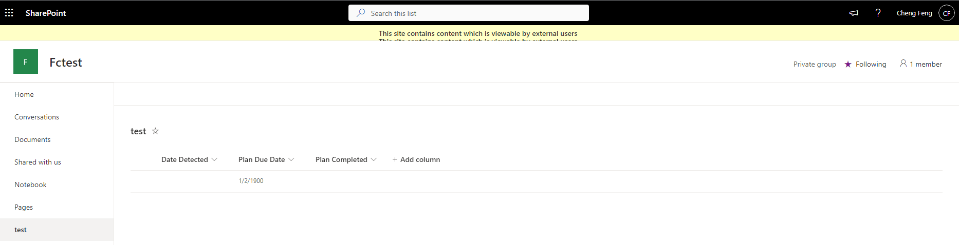

    Hi Christos Christopoulos ,
    I'm sorry, there is no Sent by email button in my scenario, and I can't provide you with detailed test results.
    But the above method should also be able to hide it.
    This is not recommended for you to use this way, because it will destroy some functions of the original page, and may cause unexpected problems on the page.
    Here is a test for your reference:

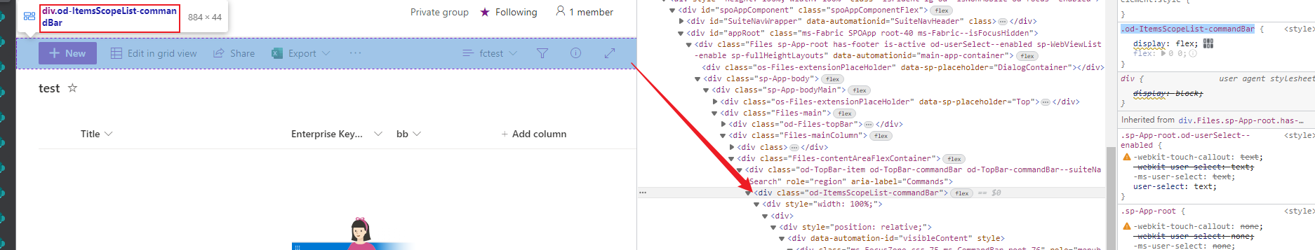

    Then arrive at the sharepoint page, press F12, open the developer mode, we need to find the class of the web part in the pageUser's image
    Here is code:
        if (!canEdit) {
          setInterval(() => {
            const element1 = document.querySelector("#O365_MainLink_Settings_container").firstChild.firstChild.firstChild.firstChild;
            element1.parentElement.parentElement.parentElement.remove();
            const element = document.querySelector(".od-ItemsScopeList-commandBar") as HTMLElement;
            if (element) {
              element.setAttribute("style", "display: none;"); // set  style  "display: none;"
          }, 100);
    Here is result:
