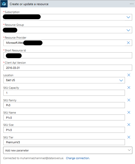

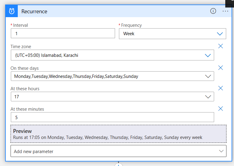

  2. Muhammad Hammad Naeem 45 Reputation points
    2023-08-04T07:04:22.44+00:00
    I used Login app using Recurrence and and ARM (create or update resource).
    https://learn.microsoft.com/en-us/answers/questions/213088/logic-apps-azure-resource-manager-connector-how-to
    https://learn.microsoft.com/en-us/rest/api/appservice/app-service-plans/create-or-update?tabs=HTTP#examples
    In Recurrence I specify the time i want to trigger the logic app
    And in ARM (create or update a resource), short Resource id will be your name of the appserviceplan.
