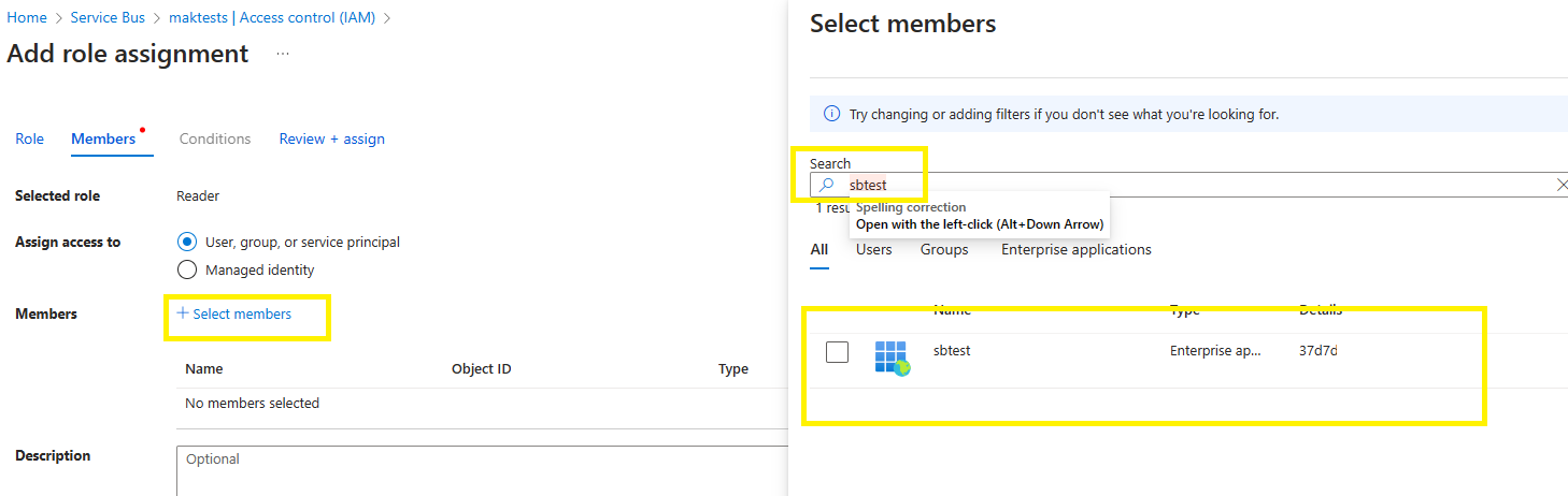

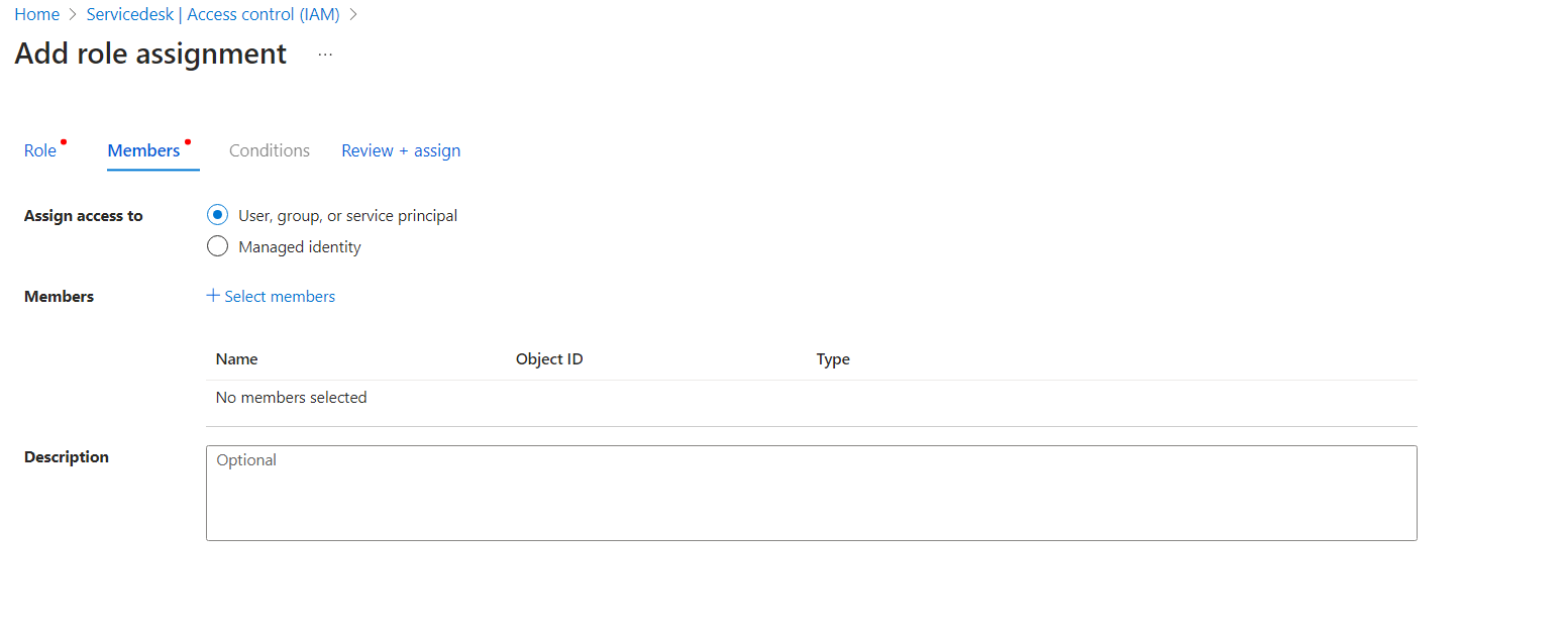

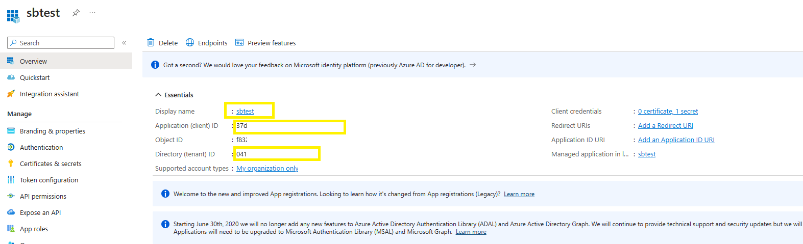

    As you are getting 401 error so I will suggest to validate this step whether you have given the right permission to your AD application. Please validate application display name matches with the role assignment that you have provided on your same service bus resource.
    Validate whether you are passing the application ID, tenant ID correctly. enter image description here
