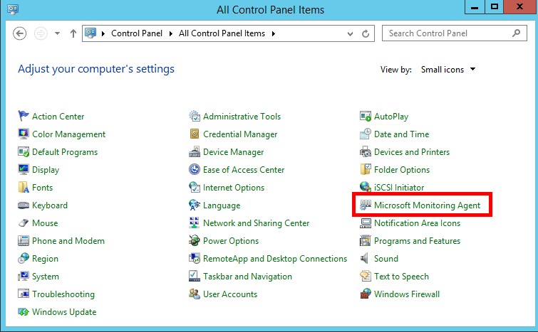

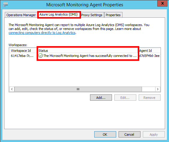

    1. You may check in control panel and see if workspace ID still exist for MMA.
    control-panel properties @Bojan Zivkovic
