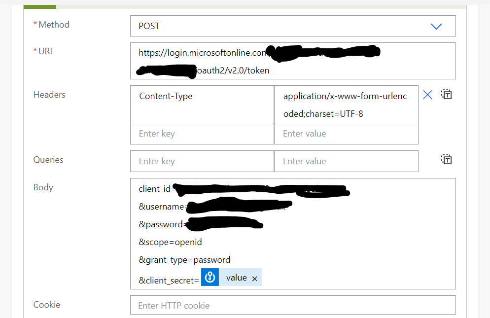

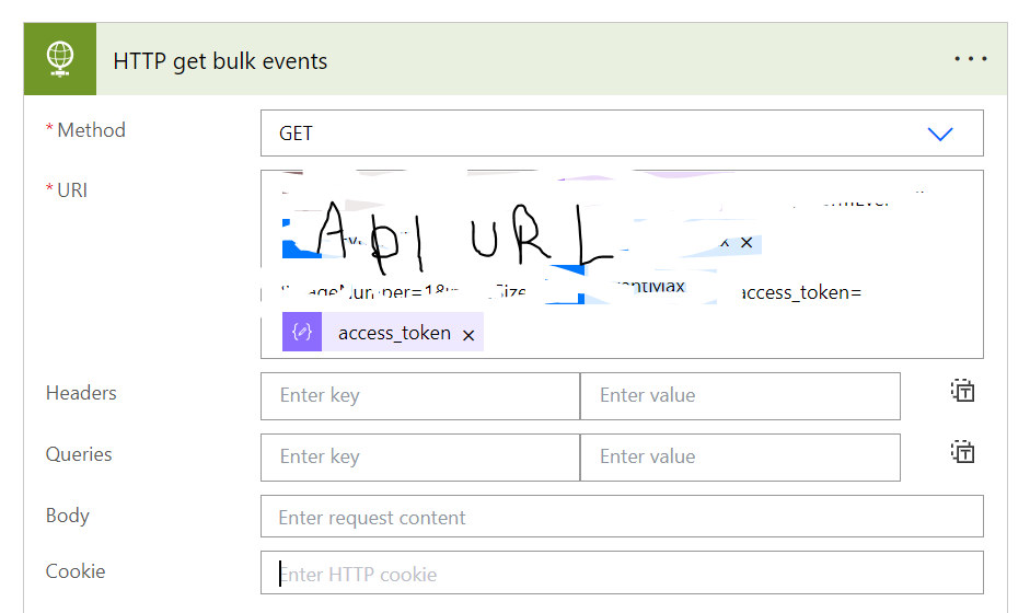

I am trying to access a json that is sat behind an app proxy. i want to do this via power automate
If i do the initial request directly to the api, i get a 302 error redirecting me to login. which then terminates the flow.
I updated the endpoint and changed it to micosoft directly and managed to login and get an access token.
However when i then use the access token to do the get request, it still redirects with the reason of invalid token.

    1. Build a custom connector in power Automate and direct it to the proxy
    2. make sure proxy is on same tenant as power automate. despite the tenant being set, it didn't work when the proxy was on a different tenant, worked after moving it
    3. if your api is not Azure AD log in but is oauth, you might need to do the work around we did and tell the api to look at a different header for authorization. You can't set authorization header in custom connector, so we passed an access-token header and got the API to swap this to auth header when it received the request.
