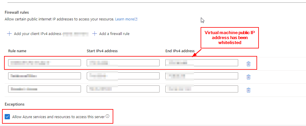

When setting up the Linked Service, I configured it to use a self-hosted integration runtime. Given that the Azure SQL database does have a default firewall to only allow access from specific IP addresses, I added the IP address of the VM where our integration runtime is being hosted. I also checked the option to Allow Azure services and resources to access this server (see image below).
Azure SQL firewall rules
