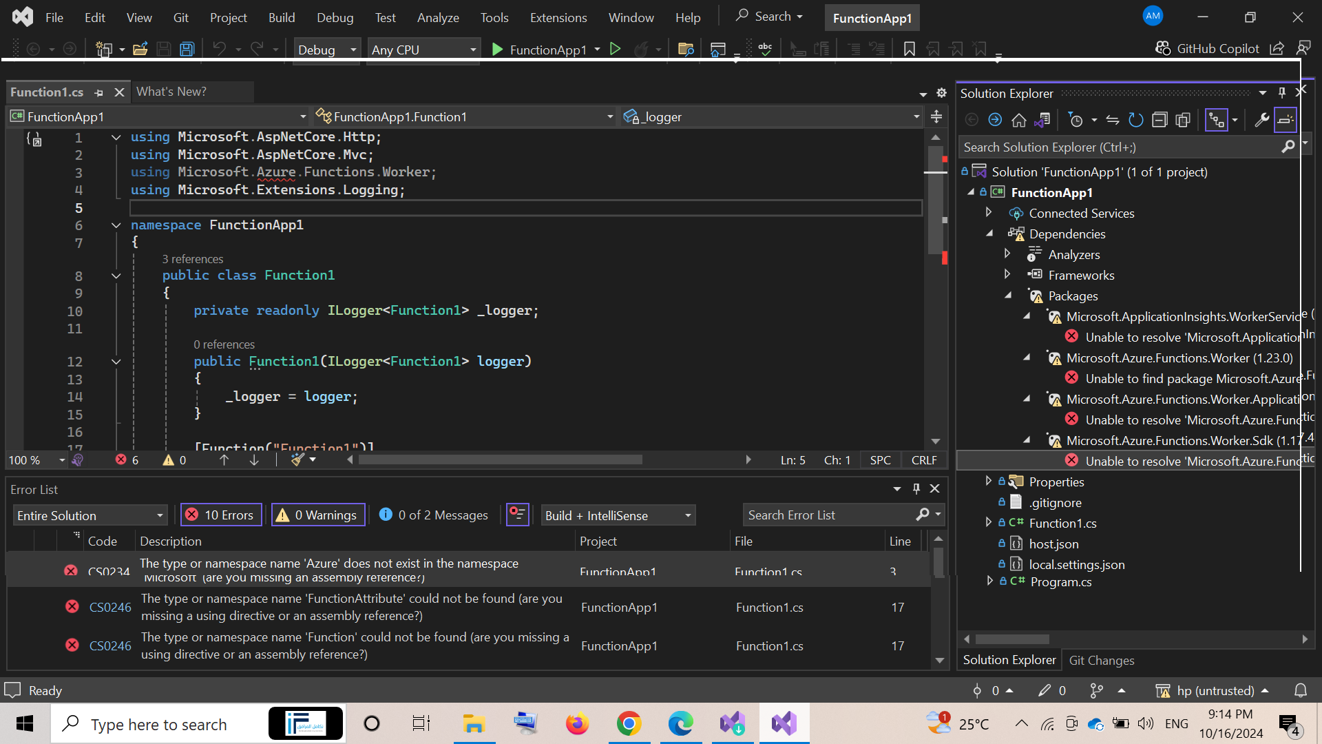

I install visual studio 2022 community and install azure packages when i try to create azure function project i get error of CS0234 which is Microsoft. Azure packed not found
2024-10-16T18:21:52.79+00:00
I installed Visual Studio 2022 community and installed Azure packages when I try to create an Azure function project I get an error of CS0234 which is Microsoft. Azure packed not found what is cause of this and what is solution to this?

    I tested locally, it seems that I got the same/similar issue.
    I did see the same error in VS Output window(CS0234). The error code indicates that this is a compile error, as you didn’t even build the project, you just create a project, you shouldn’t get this compile error.
    When you create a project, some files and packages are preparing/loading. VS checks and detects if necessary packages can be found(prepared/loaded) for the project to use, so you might see the error in the Output window.
    Normally, if you wait for seconds, this process will finish, and the errors will disappear. If the errors persist, kindly try following:

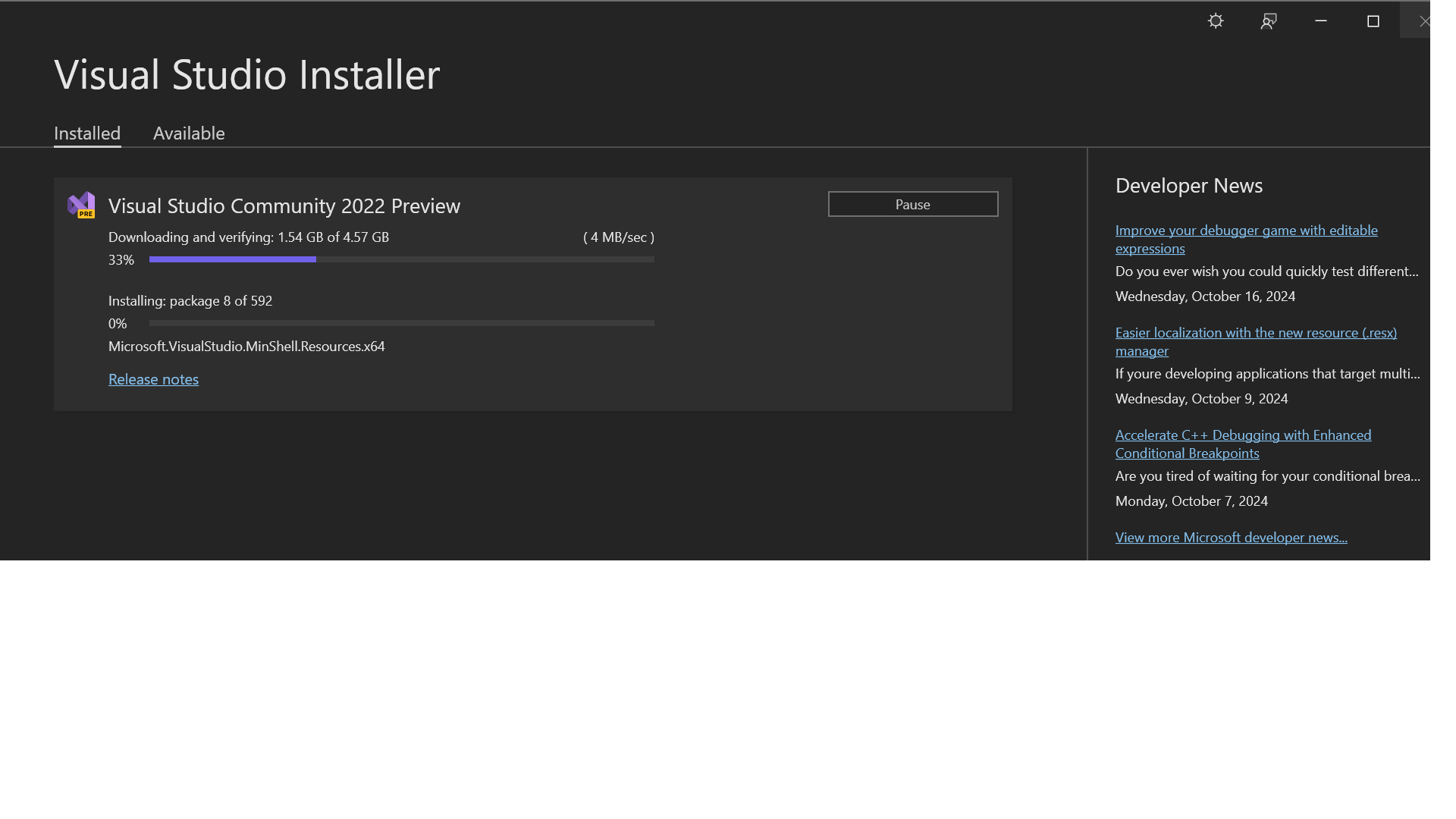

  2. Abdelmoneim Farug Abdelmoneim Mohammed 0 Reputation points
    2024-10-18T17:58:59.95+00:00
    five days ago, I saw this show many GB downloaded hundreds of packages installed but nothing worked by the end of the day. azurefunc4
