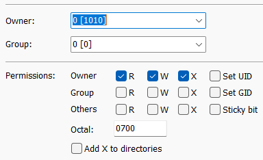

    11. With WinSCP select the user folder, open properties and set the "Owner" to the "User Id" you noted in step 8
    12. I would also remove the R and X permission for the Group as they are not needed. After this, it should look like this:
    13. User's image
    14. Finished! :)
