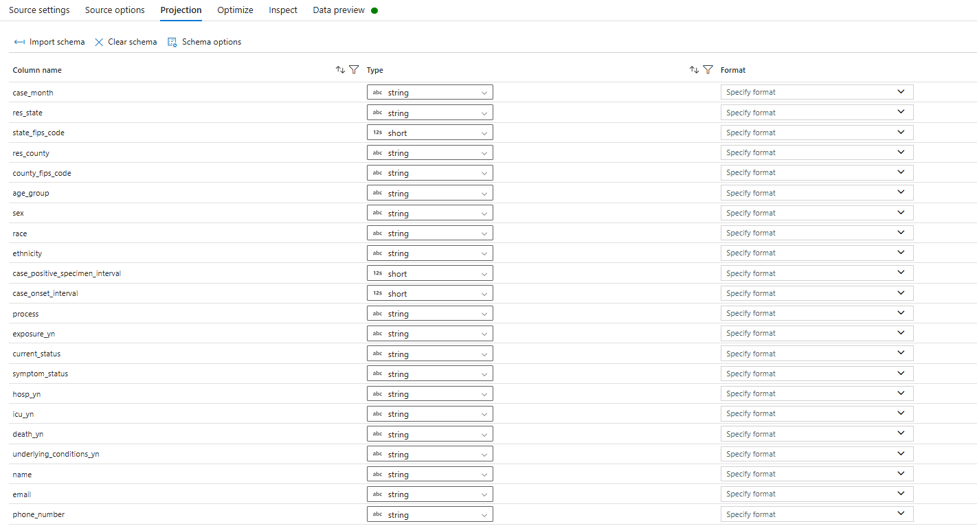

I am following the tutorial for setting up a pipeline for PII detection and masking (linked below). All steps have been followed exactly as described, without any changes to the pipeline settings or configurations.

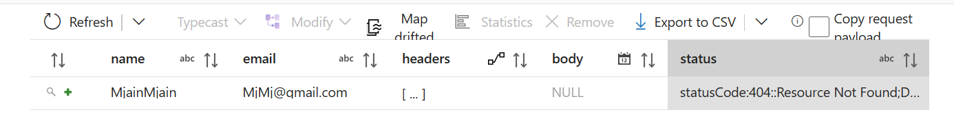

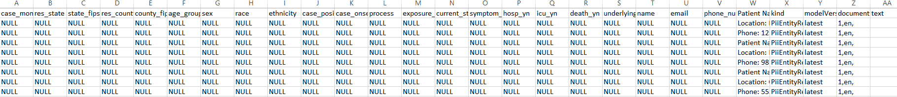

However, I am encountering an issue where the PII entities in my input .txt document are drifting into a separate column instead of being placed into the correct categories. The output does not align with the expected results. Relevant screenshots of the pipeline, including the data preview that shows the schema drift, are attached.
I would like to know:
  1. Are there any customizations needed for the CreateRequestBody or data source configurations within the data flow to correct this issue?
  2. How can the PII entities be correctly categorized and aligned in the output?

The image below is the data preview of the request body.

    If you are facing schema drift issues in ADF when performing PII detection and masking, which is causing PII entities to drift into separate columns instead of aligning with the correct categories.

    • CreateRequestBody in your data flow should be set up to correctly map input fields to expected PII categories (like name, email, phone number, etc.). If the input .txt document has columns that don’t align with the required schema, you may need to transform them before processing.
    • Inspect the input column mapping in the source transformation and ensure that fields like "case_month," "res_state," and others match the expected structure and are not contributing to the drift by being mismapped or unconfigured.
    1. Configure Column Mapping for PII Detection
    • In the data flow, specifically in the transformation where PII detection is being applied, verify that the output schema aligns with your expected categories.
    • Use the select or derived column transformation to ensure that PII entities are mapped correctly. For instance, explicitly map detected PII fields like Patient Name, Phone, etc., to the appropriate output columns, rather than leaving them to be dynamically created.

    • The source schema in your PII detection data flow may require additional configuration to prevent schema drift. For example:
      • Enable or disable schema drift as per your requirements.
        • Use the projection tab in each transformation to lock down the schema if you’re noticing unwanted columns in the output.
        • In the sink transformation, explicitly define the target schema to ensure all columns are correctly aligned.
