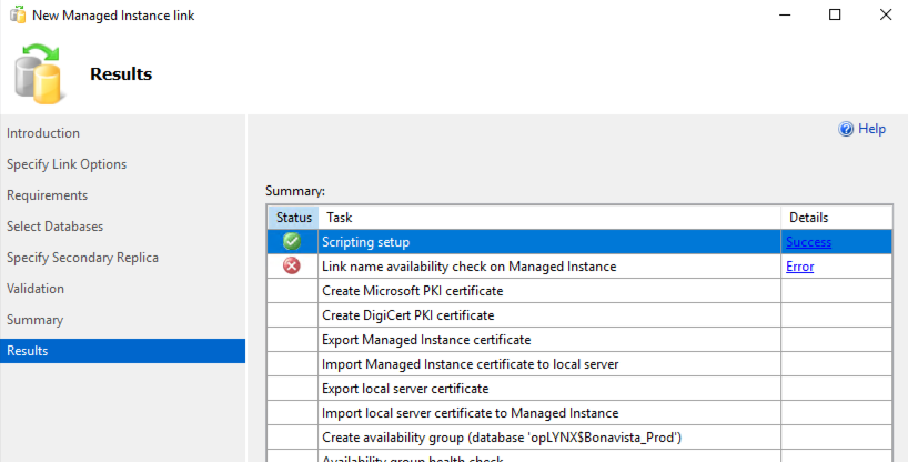

   "statusMessage": "{\"status\":\"Failed\",\"error\":{\"code\":\"ResourceOperationFailure\",\"message\":\"The resource operation completed with terminal provisioning state 'Failed'.\",\"details\":[{\"code\":\"InternalServerError\",\"message\":\"An unexpected error occured while processing the request. Tracking ID: '5634d03d-6390-406f-84ea-cf9d3def20f4'\"}]}}",
trying to create a link between sql server and azure managed instance link and getting the above issue
in the past, restarting the azure managed instance allowed it to work again however i have several azure linked servers already on it and they would need to be deleted first before retarting and redone which isnt an option right now
any help would be appreciated
