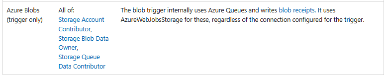

    Instead of adding "Storage Blob Data Contributor" and "Contributor" on storage account you need to add Storage Blob Data Owner to make your function host connect to storage via identity.
    Refer to this documentation, to know which RBAC role you need use based on the type of triggers.
